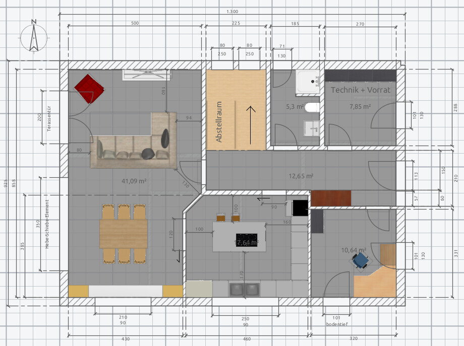

The hallway on the ground floor has quite a bit of space, but due to the doors in the entrance area, there still isn’t a practical option for a coat rack or closet. The cupboard between the stairs and the living room is too far away and situated in a narrow spot. The approximately 4m (13 feet) next to the stairs likely feels very narrow and functions only as a passageway without any real use.
Do you prefer the straight staircase, or would a spiral staircase be an alternative option?
Oops… I meant the staircase 🤨 Sorry! It looks a bit unusual in your design without a wall… or is there a passage under the stairs leading to the kitchen? Ah, right, oops, the drawing is missing a partial knee wall along the staircase. Accordingly, the door in the kitchen is an access to the storage area under the stairs.
borxx schrieb:
The hallway on the ground floor has quite a lot of space, but because of the doors at the entrance area, there still isn’t a real opportunity for a coat closet. The closet between the stairs and the living room is too far away and in a narrow spot. The roughly 4 m (13 feet) next to the staircase probably feels quite narrow and is purely a transit area without any real use.
Are you set on the straight staircase, or would a winding staircase be an alternative option? That’s true, the coat closet at the back would be too far away. However, we could take about a 1.50 m x 1.00 m (5 feet x 3 feet) corner out of the utility room, so that a coat closet could be created immediately to the right of the entrance.
The fact that the 4 m (13 feet) next to the staircase feels narrow is definitely a drawback of the floor plan. That’s why we originally planned the kitchen as a walk-through room. We’re not fixed on the straight staircase and could also imagine a switchback staircase with landings. However, it’s difficult for us to fit all the rooms into our floor plan with that option.
Unfortunately, our house is relatively narrow (9.25 m (30 feet)) and long (13 m (43 feet)). Since the location of the living/dining area is fixed in the west, with an entrance in the east, at least 8 m (26 feet) (13 m house length minus 5 m width of the living/dining area) must be covered between the front door and the living room. Changing the staircase design doesn’t affect this. Only an entrance from the north would help. But that would also mean the entrance wouldn’t face the street and we’d have to walk halfway around the house each time. Also, the northern side is quite tight because we only have a 3 m (10 feet) setback from the property boundary. So an entrance from the north is basically not a real option for us. What do you think?
Hello Rapha,
to avoid this pipe, you need to open the utility room and combine the dining area with the kitchen. I already mentioned that. If you don’t want to always pass by the kitchen, you can move the dining area forward and place the kitchen at the back, equipping it with a large west-facing window above the countertop. I’ve sketched my idea for you and found a photo to show how I imagine the kitchen. If needed, you could also separate the living room with a sliding door. I would position the main terrace directly behind the kitchen window. This has the advantage that you won’t be looking at table and chair legs because it’s a low sill window. Access to the terrace would then be through the living room and the south side of the kitchen. I would add a small additional terrace on the south side as well, where you can enjoy the morning sun from the east.
After our last floor plan was completely rejected, we sat down with a friend who is an interior designer and started from scratch. The following floor plan is the result, and we would like to hear your opinions on it.
We think this version turned out much better. The only thing that still bothers us is that you can’t see the garden (to the left on the plan) from the sofa, and we can’t fit a hanging chair in the living room. We had the idea to rotate the sofa so that it divides the space and faces upward on the plan. However, this would make everything a bit tight, and the corner between the dining room and kitchen would have to be replaced with a slanted wall, which means the sliding door between the kitchen and dining room would have to be smaller. What do you think?
I already welcome the willingness to move away from the single flight staircase, but otherwise I remain rather cautious in my enthusiasm.
