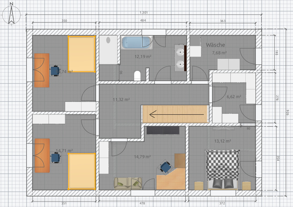

I quickly refined your plan a bit and fixed some errors. But I feel you could reduce the floor area. The children’s rooms are now 16 sqm (172 sq ft). I didn’t check the bedroom, but it’s obviously quite large.
I would shorten or narrow the house by about half a meter to one meter (around 2 feet to 3 feet) and, for example, reduce the size of the walk-in closet, bedroom... The storage room could be removed or combined with the bathroom.
Downstairs, the living area is quite generous, and many dream of a multifunctional room over 10 sqm (108 sq ft). That would help relax the budget as well.
This was a quick suggestion... Edit: I would change the bedroom door to the hallway to have a shorter toilet route... the hallway could be shortened as well. Yes, quite big.
[ATTACH alt="Screenshot 2021-07-05 at 16.59.44.png"]63377[/ATTACH][ATTACH alt="Screenshot 2021-07-05 at 16.59.54.png"]63378[/ATTACH]
Thanks so much! This also looks interesting. We would close off the kitchen, but that would be easy enough. The issue with the utility room on the upper floor remains, especially if the bedroom entrance is from the hallway.
I haven’t addressed every single point individually, but we have read everything and tried to incorporate the raised points as well as possible.
Below you’ll find the updated floor plan. What do you think? What would you do differently?

Floor plan of a house: living room with dining table on the left, kitchen, bathroom, technical room, home office.
Floor plan of an apartment with several bedrooms, bathroom, laundry room, and living room.

Are there any other opinions on the updated floor plan?
Floor plan: living/dining area on the left, kitchen below, office above, technical room on the right, bathroom bottom right
Floor plan of an apartment: three bedrooms, living room, bathroom, laundry room; beds, sofa.
