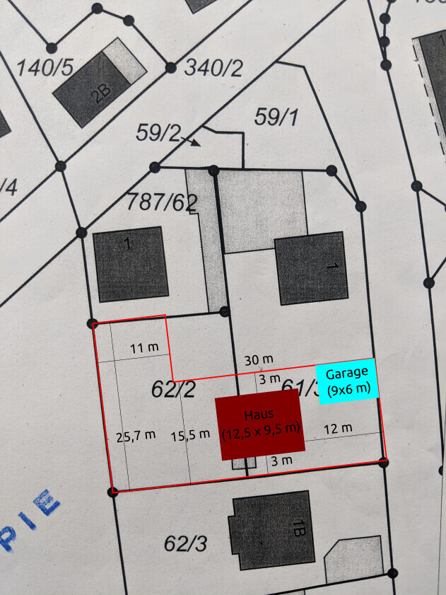

we have already had several discussions with construction companies and have now arrived at a floor plan we are quite satisfied with. However, we are finding it difficult to choose the right builder and are not entirely sure if the floor plan is truly optimal. Also, we have not yet decided whether to build a prefabricated house or a solid (conventional) house.
Plot size: 765 sqm (8,236 sq ft)
Slope: no
Site coverage ratio: 0.4
Floor area ratio: 0.5
Building envelope, building line and boundary: 9.5 x 20 m (31 x 66 ft). The plot is 15.5 m (51 ft) wide and a setback of half the eave height (at least 3 m (10 ft)) must be maintained.
Boundary construction: possible for the garage
Number of floors: 2 full stories (or a high knee wall > 2 m (6.5 ft) to keep the eave height under 6 m (20 ft))
Roof type: no specification known
Architectural style: no specification known
Orientation: see site plan
Maximum heights / limits: eave height max. 6 m (20 ft) or accordingly higher setback distance
Other requirements: none

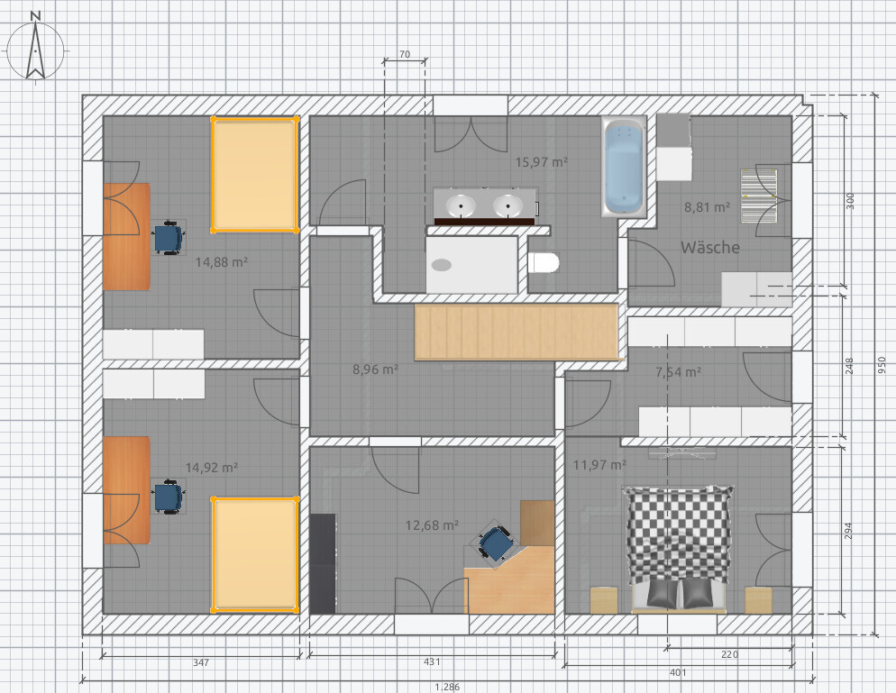

All the required rooms were included; minimal circulation areas; no wasted space; utility room directly next to the bathroom on the upper floor
What do you not like? Why?
We don’t like the bathroom layout because there is little natural light in the room

Site plan of a plot with house floor plan, dimensions, and garage highlighted in color.

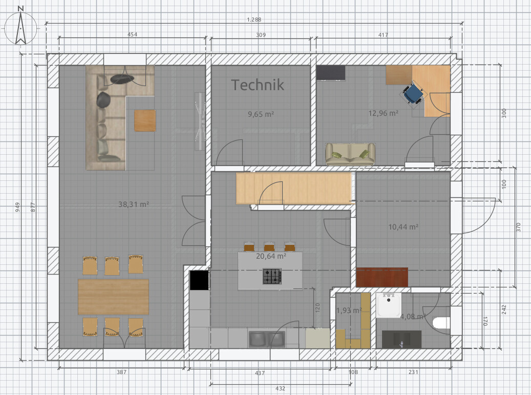

House floor plan: left living/dining area, central kitchen, technical room, office, bathroom.
House floor plan with bedrooms, workspaces, bathroom with double sink, bathtub.

And how are the speakers going to be installed there?
To me, this kind of room layout feels a bit like the furniture displays in furniture stores, where every 4 meters (13 feet) there is a different setup. It’s like a separation of units.
Have you considered having the living room with TV/home theater as one space and the kitchen/dining area as another separate room?
This also has the advantage that when you have guests visiting separately, you have two distinct living areas.
25 Aug 2021 23:33
A thoughtful response from you. That’s rare to see 🙂
Regarding your comments:
Rapha811 schrieb:
Our standard sitting/lying spot is on the short side of the sofa. It comfortably fits two of us there.
I remind you that you’re planning for two! children. Families usually sit together in front of the TV 😉
Rapha811 schrieb:
Is that meant as criticism, or do you think the design is on a pretty good track?
Let me put it this way: if the speaker setup is that important to you, it should be properly integrated into the design.
I can’t contribute much on that... I used to have those wired setups (3D effect, stereo) and didn’t really like the audio or the look.
Rapha811 schrieb:
Please only consider the living room; I haven’t adjusted the rest yet. We actually like using the sofa as a room divider.
If you like that, then keep working on it. I don’t see speakers in the middle of the room as user-friendly. Can’t they be installed on or recessed into the ceiling somehow?
Rapha811 schrieb:
Well, with a standard kitchen unit, you look at the wall anyway. Most of the time you’re standing at the sink, so it’s important to us to have a view out the window there.
I built specifically to avoid a standard kitchen unit :p
No, I do stand at the sink multiple times, but only for very short periods, while most of my work happens next to the stove. From my island, I can look out into the garden and the greenery. My greenhouse is about 20 meters (65 feet) away, so I can see that <3 Between those is my amazing dining table, which I never get tired of looking at. Of course, you want the terrace connected visually when eating or grilling outside.
Planning windows by the sink originally comes from the need for daylight so you don’t have to turn on lights during the day. Nowadays, hardly anyone washes dishes by hand thanks to dishwashers 😉
Rapha811 schrieb:
Maybe I don’t quite understand what you mean by “generous.”
Well, it’s about how you see your house while living in it.
It often concerns sightlines from a frequently used spot looking in one direction, leading to a view stretching into the garden. This opens up the space; nobody wants to look at a wall. (Not even from the bathroom!) Ideally, from the front door to the back of the garden, with a beautiful door and decoration in the hallway... or the cooking area with dining space, then a terrace door, a nicely decorated terrace, and in the background a lovely flower bed...
You create a visual picture that you will see daily and that is aesthetically pleasing. That’s how architecture works 🙂
Rapha811 schrieb:
Do you have examples of similar floor plans you consider successful?
There are plenty... I think you’re missing the visual aspect of seeing rooms flexibly. For you, everything has to have a fixed function with doors that can be closed. But a home office can also be integrated with other functions; the trend for flexible room usage started over 20 years ago.
A kitchen is not just for cooking but part of the living concept; one of two offices could be open in a living corridor accessible to everyone, and so on.
... it’s also worth thinking about if you realize you have too many rooms, some of which might be unnecessary, or if your plan is strained by a long corridor without additional use. Then I would at least consider whether a slightly more open corridor with multiple uses could add more value.

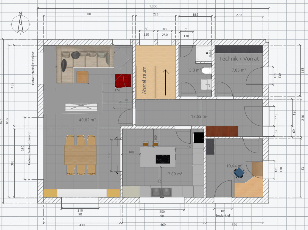

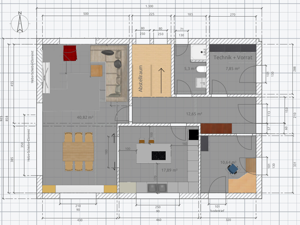

Have you considered using a half-height room divider instead? There are so many great options available nowadays. Possibly combined with a gas fireplace as a visual highlight. Try searching for “freestanding TV room divider.” I personally find it quite uncomfortable to sit with your back to the dining table, staring at a wall instead of looking into the room and/or the garden. Especially if you have children who play or do crafts at the table in the open living-dining area, you want to have the space in view. With kids, the sofa and living room really take on a different meaning! And the TV is likely to lose their attention.
2D floor plan of a house with living room, kitchen, dining area, and hallway
If it were my house, I would probably favor the solution proposed by kbt09, but reposition the windows. A large lift-and-slide door and an additional north-facing window open up the space most beautifully. I don’t understand why the speakers couldn’t be mounted on the wall behind the sofa (at its corners, basically). We have it like that, and the sound is excellent.
