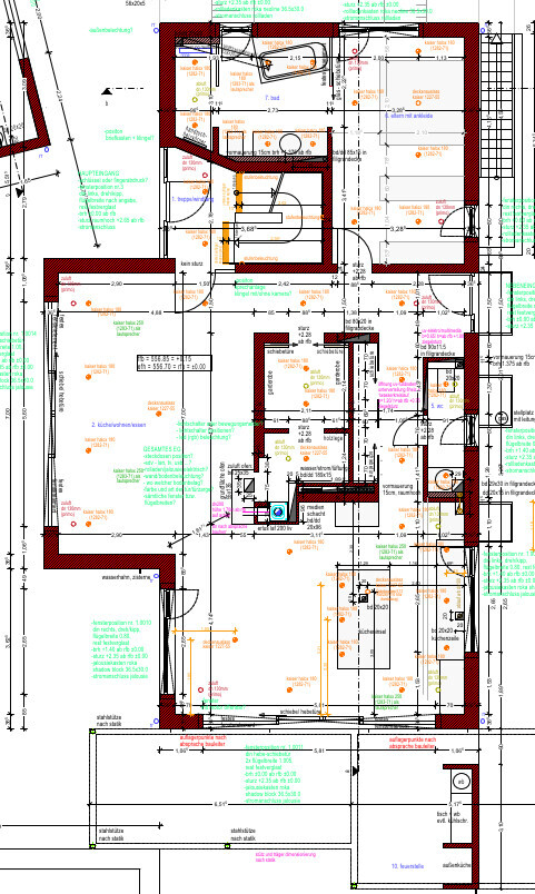

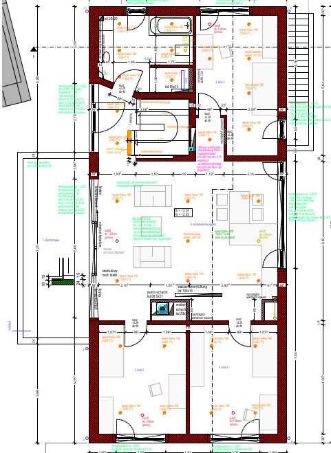

We are planning to include a second bathroom on the upper floor, but underneath on the ground floor there is actually no bathroom or kitchen, meaning the plumbing shaft is essentially located in the middle of the living/dining area. However, we are planning to install a fireplace exactly there. Now the question is: Could we place the plumbing shaft directly next to the chimney flue? If this projection is somewhat wider, it shouldn’t affect the appearance much, since a kind of panoramic fireplace is planned in front of it anyway. I hope I have made my idea clear.
If that’s not possible, could the plumbing shaft perhaps be moved so that it doesn’t run through the living room but instead through the guest room? What is the maximum flexibility here, or does the shaft have to run directly down from the bathroom?

If you’re not certain that your floor plan works, you go to the architect without any drawing and tell them what you want.
You already wrote here yourself what you want with the kitchen, TV, etc.

Maybe a silly question, but why don’t you enlarge the guest toilet on the ground floor to include a shower instead of squeezing another bathroom upstairs? That way, the guest room also benefits. Currently, 2.24 m (7 ft 4 in) is planned for the wardrobe in front—wouldn’t 1.40 m (4 ft 7 in) or 1.20 m (3 ft 11 in) be enough?

That’s not a silly question at all; I actually modified it here based on the feedback so that the wardrobe ends up being 1.60 meters (5 ft 3 in):
