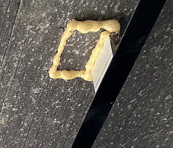

Please show a closer view of the ceiling suspension with the yellow spacers.
@11ant
This is outside the house. Above it is a terrace.
Our ventilated facade (aluminum composite panel) is wrapped around the corners and also used as ceiling cladding for terraces/balconies.
The "yellow nubs" surround the spacers of the battens.
These are thermally separated from the house. Since the ceiling is additionally insulated, these areas had to be cut out.
To maintain as continuous insulation as possible, the holes were carefully filled and glued with cut-to-fit insulation. The yellow material is excess foam.
