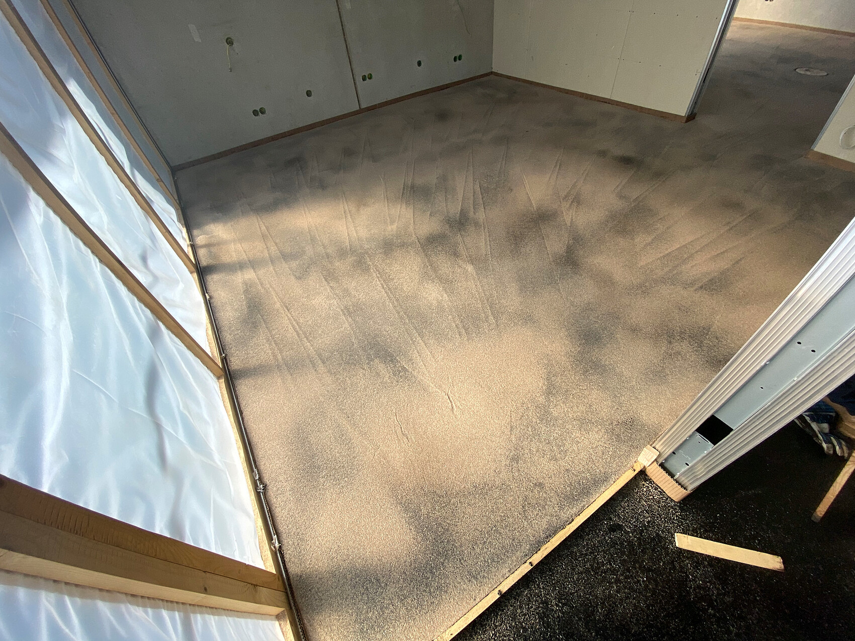

As planned, work began today on the second and final layer of poured asphalt.
Interior under construction with bare walls, protective sheets, and dusty floor
In the photo, you can also see the excess filler material. The asphalt was still at 100°C (212°F) at that point.
In the bottom right, you can see that there is sometimes some debris lying around on our construction site as well.
I am still standing on the first layer from yesterday.

As planned, the second and final layer of mastic asphalt was applied today.
Is this inside the house, or why use mastic asphalt indoors? I only know asphalt for paths or roads.

In a hot state, for example during processing, hazardous emissions from the bitumen content must still be expected. Protective measures according to technical regulations should therefore be strictly followed.
Where exactly were the protective measures visible again in the photos?

@annab377 I guess you haven’t read much of this thread yet. In our construction project, some things are done differently, more specifically, or less commonly. Have a look at a few pages earlier where I listed some reasons (seamless, warm underfoot, flexible, waterproof—for example, also in the shower, etc.). Or try searching for Bituterrazzo. In general, it requires more effort because everything has to be designed to withstand the high temperatures during application. The advantages outweigh the effort for us. Our style is Bauhaus.
