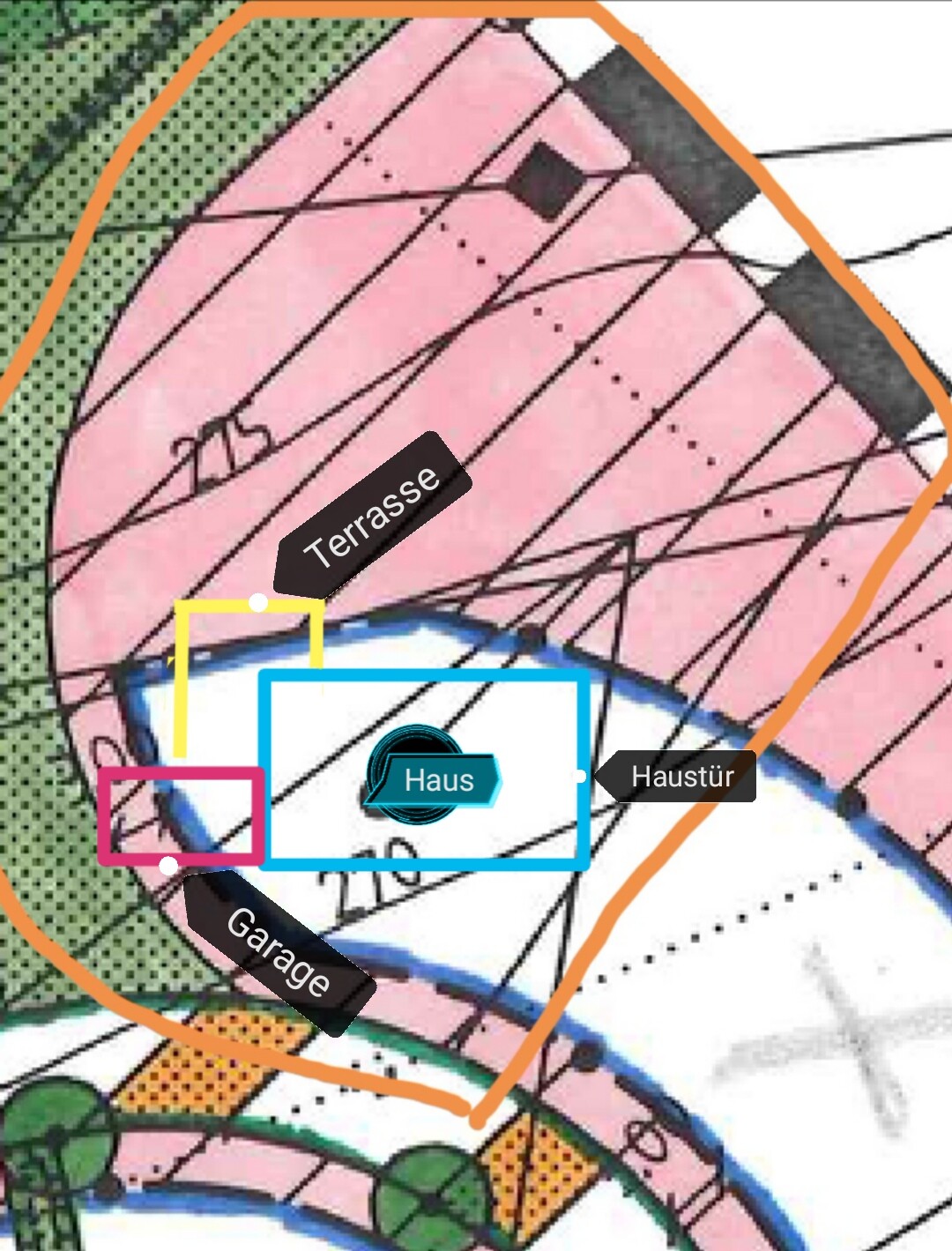

Hello everyone and thank you for the responses.
I have now roughly sketched the house including the garage and terrace on the site plan. The orientation corresponds to a typical map view, with south at the bottom.
I think this makes things easier and already answers some questions. See attachment.

wibble schrieb:
The sports room is intended to be a bouldering roomWhat is that?I find your guest room reasonable. No one should really object to having a shower either.
However, I wonder if the basement is justified at all. It sounds as if it is only intended for the cats, since laundry is done upstairs.
Also, no offense, but it seems to me that upstairs looks too much like playrooms are being planned, with the living spaces having to adapt to that.
wibble schrieb:
Bedroom size: I thought 1 meter (3 feet) of space on each side next to the bed would be enough if you have a walk-in closet, since you only sleep in the bedroom. What size do you think the bedroom should be?Well, you are planning a house over 200 square meters (2,150 square feet), but the bedroom is a small chamber.Depending on the slope of the site, I would consider taking a different approach: a basement with storage rooms and an open south-facing area including an exit and terrace, and the rest on the ground floor with access to the main garden, for example, office and playroom on the ground floor, living area in the basement. The cat will also have a place somewhere if planned properly.
Hillside properties should always be entrusted to experienced architects.
What is a cat room needed for?
I had up to five of my own. I only used a separate room for rescued cats that needed special care.
On the ground floor, the path from kitchen to dining area to terrace bothers me.
I would completely redesign the upper floor.
Too convoluted, partly too small.
See if you can find the floor plan from
@Climbee. It should have roughly the same room layout.
Bouldering is climbing without a rope.
Do you really want that inside your house? Who’s going to keep moving the holds?
I would definitely set it up in the attic, where you basically get the overhangs "for free." Chimney climbing isn’t really typical in bouldering... And if you eventually outgrow the boulder (it does happen), you’ll have a room that wouldn’t be usable otherwise. That’s something to think about...
So, we want a usable basement. The cats are supposed to sleep there at night, otherwise they wake me up. That’s what we mean by a “cat room.” We absolutely want a basement. Here, we only have one basement room, and it’s terrible. We spend a lot of time working in the garden and need to store the necessary equipment, bicycles, possibly a fitness room, an overnight room for the cats, and the main home office should be in the basement. There might also be space for a second hobby room upstairs, which would help to relieve the upper floor. The terrace should definitely face the backyard. Because of the slope, you sit back there surrounded by greenery, and due to the lower neighboring plots with bungalows, you have complete privacy. A spacious garden is very important to us, so we searched extensively for a plot with at least 1000sqm (12,000 sq ft) and connection to meadows.
It’s true that the room is hard to use if it’s no longer for bouldering because of its layout. I actually drew it last because the shape doesn’t really matter. Since we’ve been doing the sport for 10 years and practice daily, our only option was to either find a plot near a climbing gym or take an affordable plot and give up 15sqm (160 sq ft) for the bouldering room. Since my wife is passionate about setting routes, that shouldn’t be a problem.
I will revise the upper floor plan again and make changes. Thanks for the suggestions. The house will probably be about 180sqm (1,940 sq ft), considering the walls and so on. I would also like to build it smaller to save costs, but then I don’t think our wishes can be met anymore.
