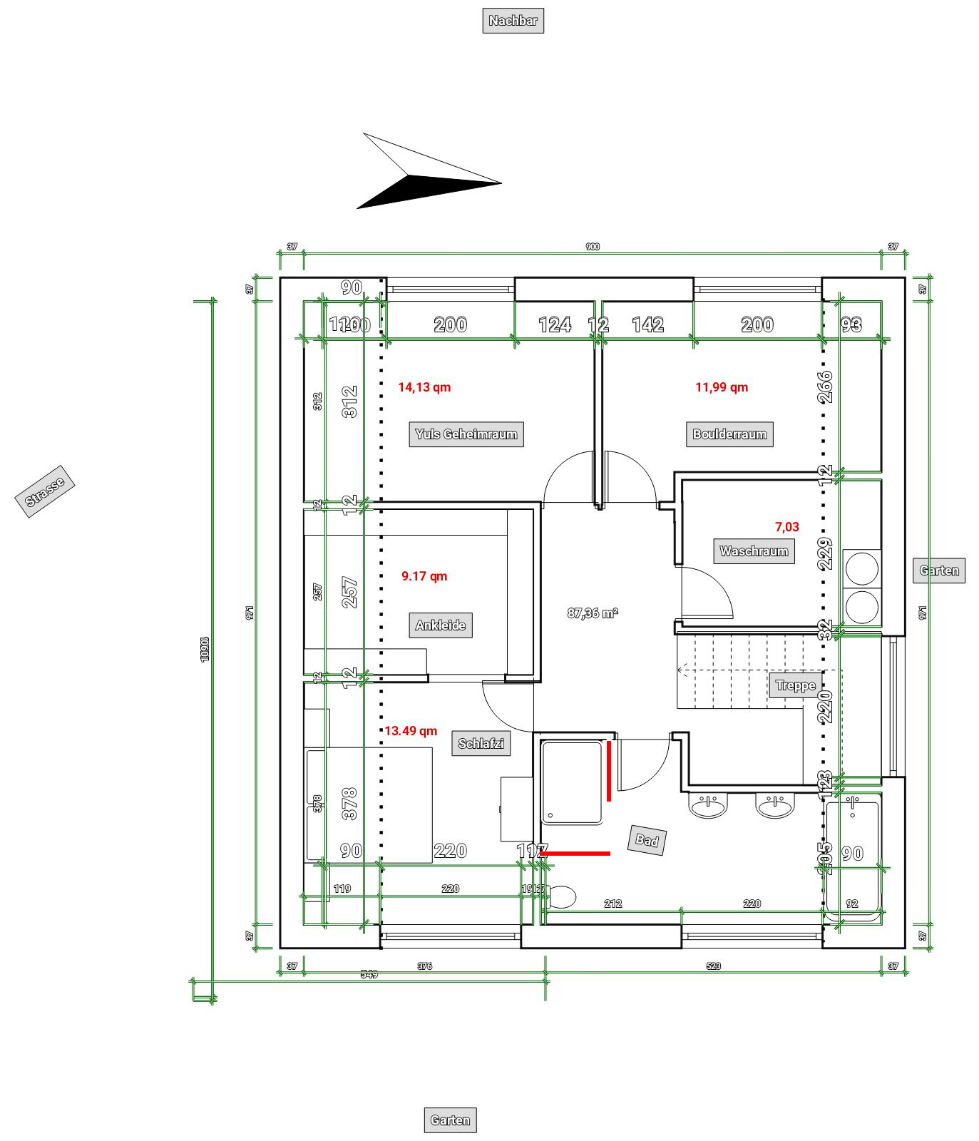

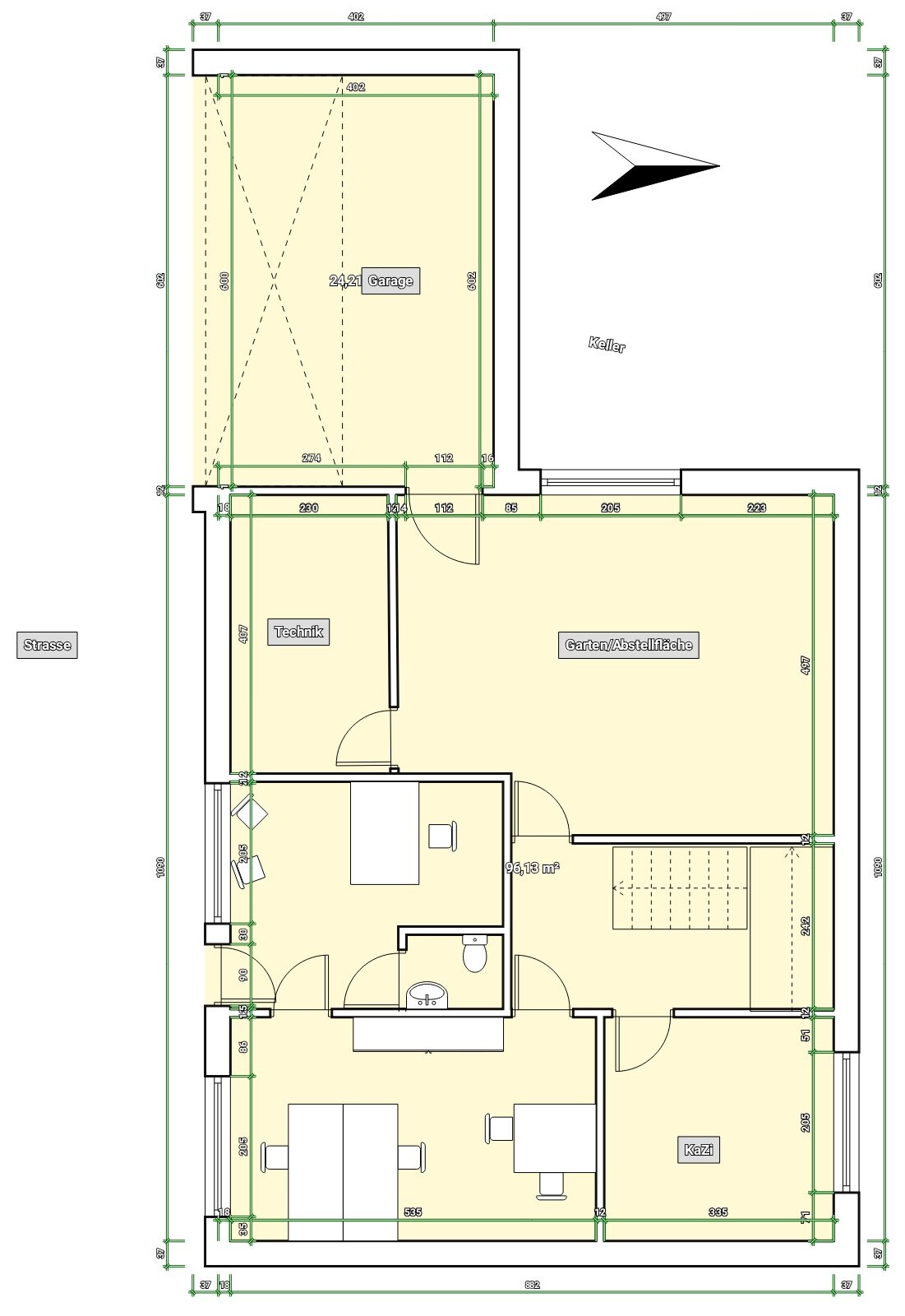

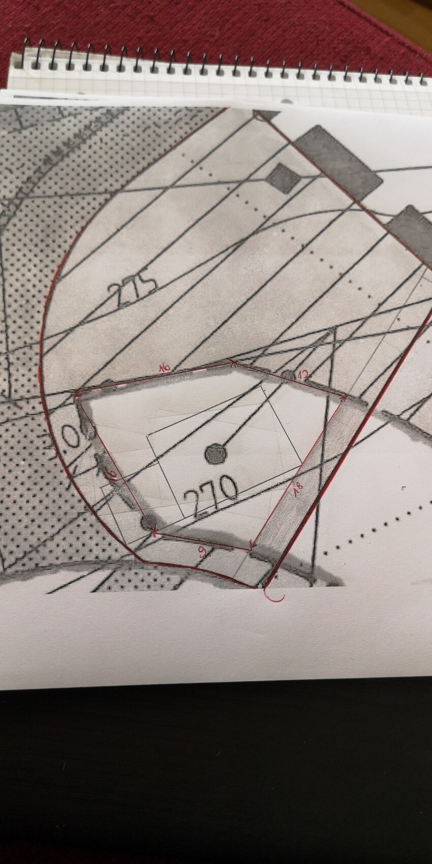

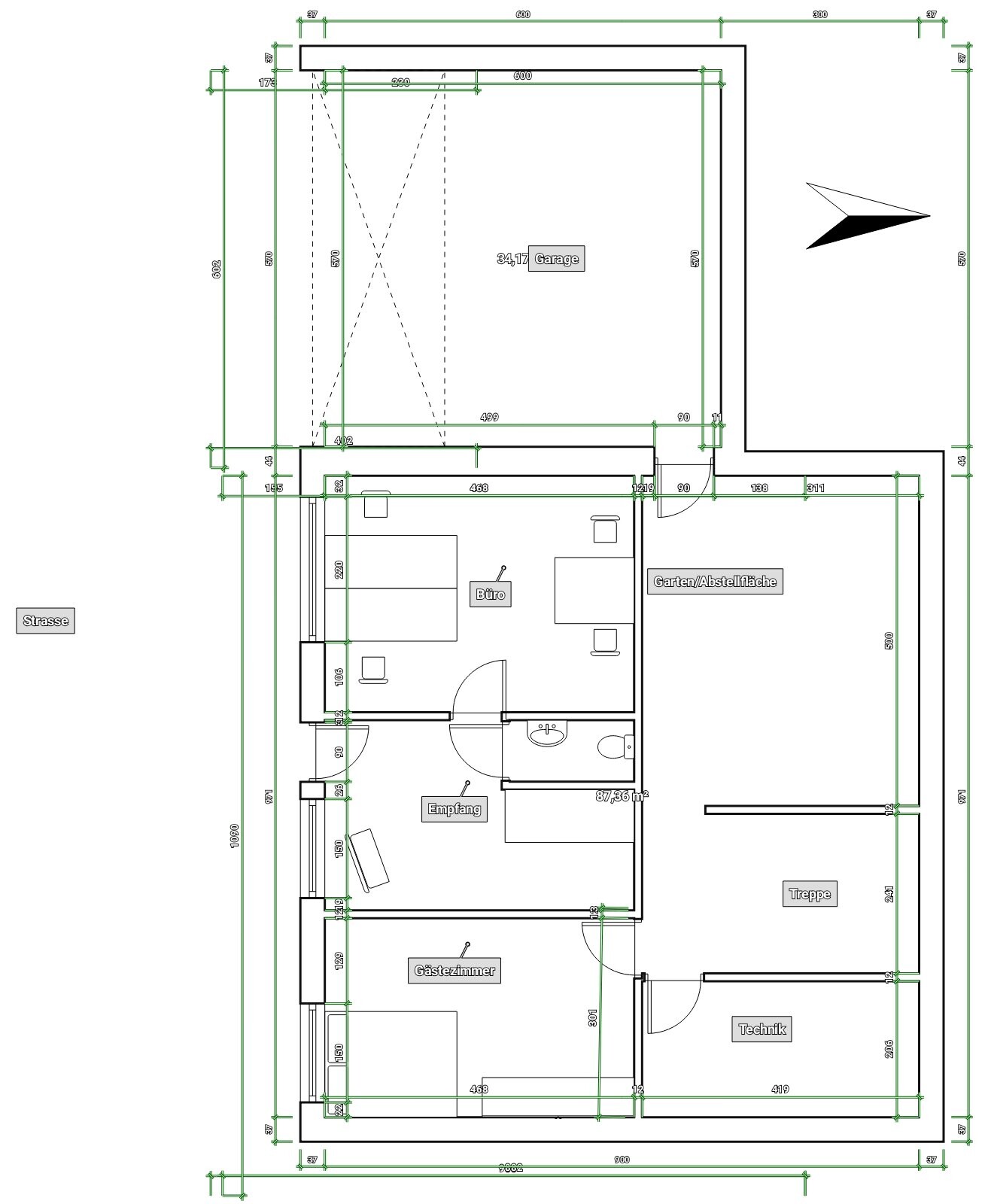

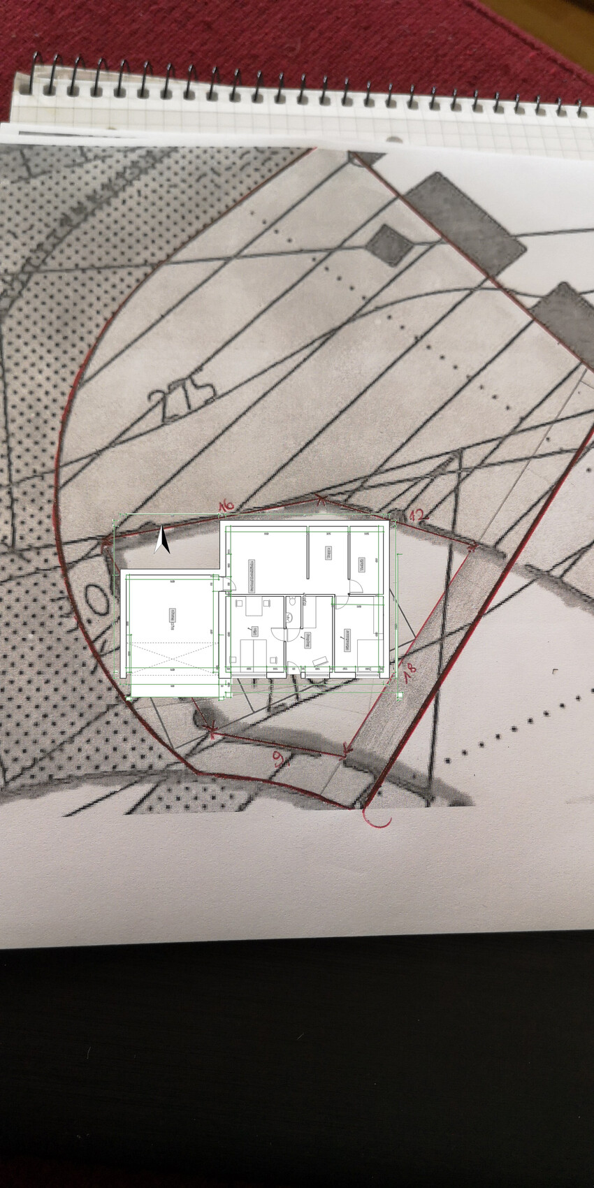

kaho674 schrieb:
So, should I imagine it like this?:
[ATTACH alt="platzierung.jpg"]47099[/ATTACH]
Does a staircase lead to the main entrance?
Where is the terrace?

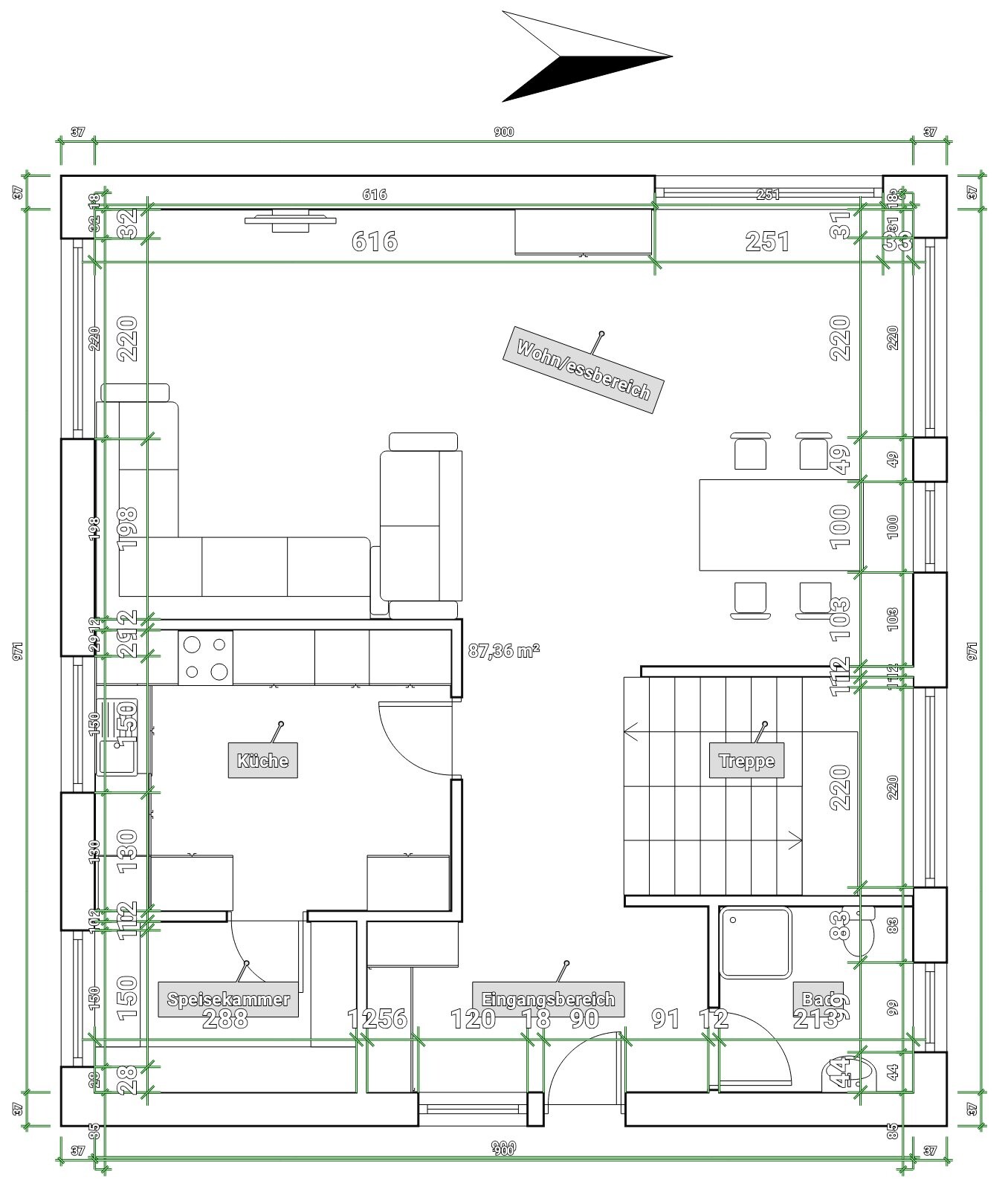

The bottom part is cut off. You can’t see the road layout. Is it easy to get into the garage this way?
Otherwise, I think it’s pretty good. I’d find it annoying if the toilet in the bathroom always gets wet when you shower – or is that not a walk-in shower?
I’m not a fan of a locked-in dressing room either – I’d rather have access through the dressing room to the bedroom.
I’d also find the garden design here very interesting. It’s drawn exactly like this.
It is a walk-in shower, but I’m still not quite happy with the bathroom on the upper floor. Do you have any better ideas?
The terrace is basically behind the garage, but because of the slope it is at the same height as the garage roof, so it’s not shaded.
kaho674 schrieb:
Well, that’s probably why some people are confused, because the sketch is either not oriented to true north or the north arrows on the house plans are incorrect. As you can see, in my attempted placement the north arrow points upwards.The sketch is oriented to true north (north at the top, south at the bottom). I also thought the north arrow was correct.. O.o I need to take another look at it.
Hmm, then I probably don’t know how to draw a north arrow. oops: Actually, we wanted to position the whole house at a slight angle so that it aligns with the contour line. For the entrance, there should be either stairs or a path, depending on what works better. I haven’t looked into that in detail yet.
In any case, the entrance is on the east side. The living/dining area is on the west side. The kitchen is on the south side. The staircase is on the north side.

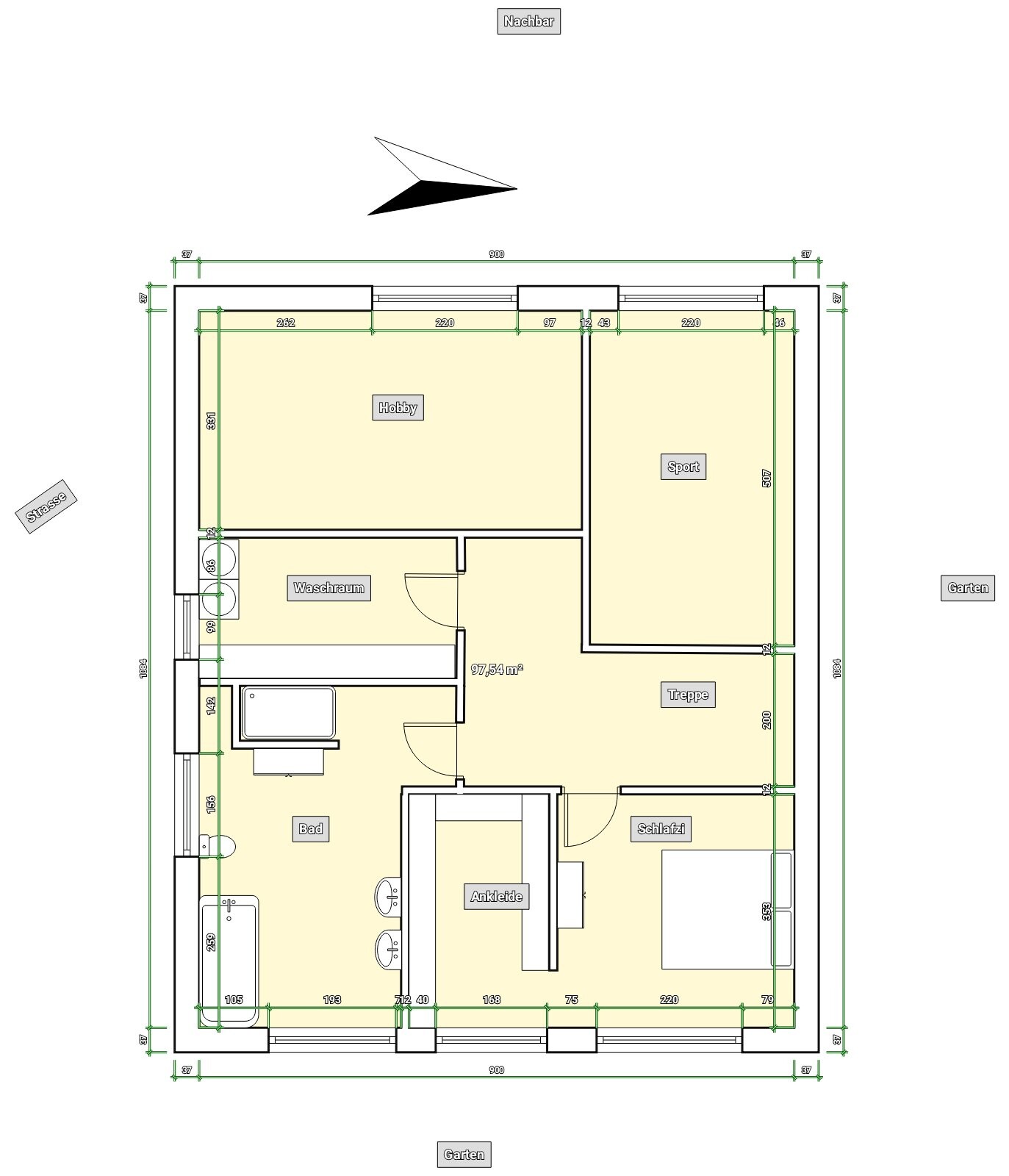

wibble schrieb:
This is a walk-in, and I'm still not really happy with the bathroom on the upper floor. Do you have a better idea?
Well, quickly:
However, it needs additional spotlights.
kaho674 schrieb:
Well, quickly put:
However, you need additional recessed lights.Yes, I have thought of that too. But because of the darkness, it's rather not ideal. Daylight is definitely nicer than spotlights. But yes, if necessary…
