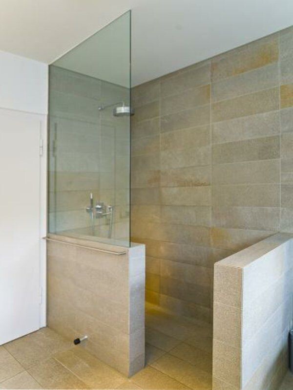

kaho674 schrieb:
You could also swap the shower and bathtub.But there is a sloped ceiling there.wibble schrieb:
But there is a sloping roof there.Oh yes, I had overlooked that, sorry. Then we'll stick with proposal 1, with a solid wall below and glass above. Next to the toilet, a half-height splash guard will be sufficient:
kaho674 schrieb:
Oh yes, I overlooked that, sorry.
So we'll stick with option 1 with a wall at the bottom and glass on top. Next to the toilet, a half-height splash guard is sufficient:
[ATTACH alt="dusche.jpg"]47138[/ATTACH] Thank you. The half-height option sounds great.
