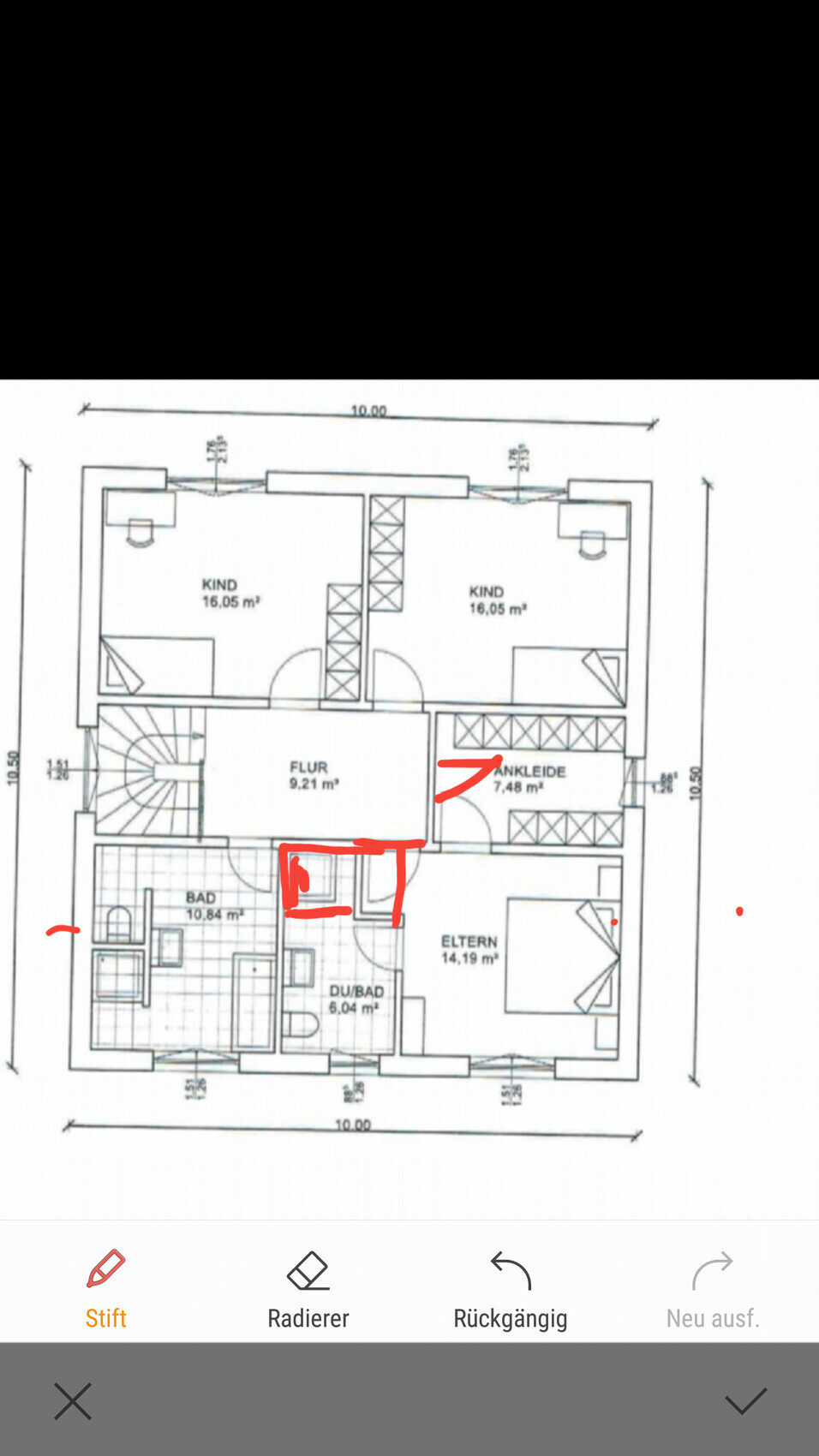

Shiny86
1 Apr 2020 11:38
@ypg
I actually want a lot of things, it’s clearly nice to have. But I don’t want to have them at any cost.
We also feel quite left on our own by the architect. We’re going around in circles. He’s just a draftsman; we never got any input from him.
He knows everything we want, but he didn’t come up with any ideas himself.
I didn’t think the swap between kitchen and living room was bad. But he kept drawing that section of wall with the 20cm by 20cm (8 inches by 8 inches) opening two or three times, and we always told him we didn’t want it like that. Now there is an awkward recess in the guest room. He can figure no one wants that. I’ve now realized that you can’t have everything, and I am willing to compromise on the master area as well. What matters to me is having the dryer and washing machine on the upper floor and showers that don’t need doors. For example, I don’t mind if you have to go through the dressing room first to get to us. It just happened that way.
So maybe the bathrooms could be moved to the north side, meaning the bottom of the plan—then there wouldn’t be drainage in the TV corner, right? There’s only one floor penetration in the kitchen, so that’s not a problem, or am I missing something?
Maybe I expect too much. But the architect can definitely make suggestions too. Just sketch something by hand.

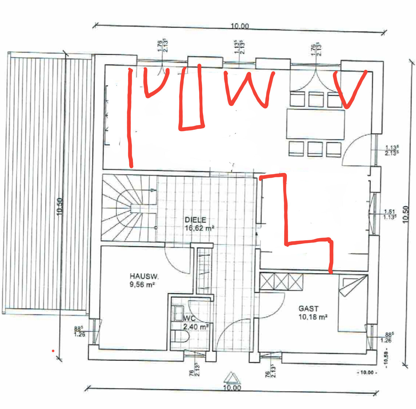

Shiny86
1 Apr 2020 12:00
Ok @11ant
I’m taking your advice to heart.
This is my very first draft.
However, I swapped the living room and kitchen. I hope my sketch is clear enough to understand what it’s supposed to show.
The washer/dryer no longer fit on the upper floor, but I would still include the second washbasin with the T solution.
I would have to give up the landing stairs. Since I didn’t want the U-shaped staircase, everything started to change with the stair configuration.
There should be no protrusions or drainage in the office or living room now, right?
Floor plan of the upper floor with two children’s rooms, master bedroom, dressing room, hallway, bathroom and shower/bath
House floor plan: foyer, guest room, utility room, WC; red lines mark paths.
