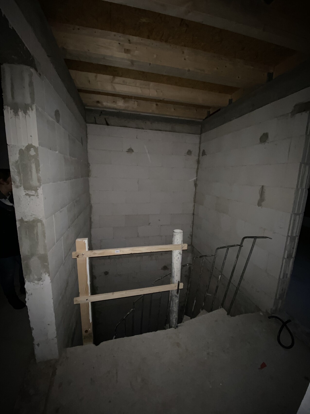

goalkeeper4 Jan 2020 17:10We just came back from the construction site and are wondering why we didn’t have a floor installed on the left side of the stairwell in the attic, for example, to create a storage room. Or is there a flaw in our thinking? The staircase, like the construction stairs, comes up on the right – the stairwell is 2.20m (7 ft 3 in) wide.
Would it even be economically sensible and feasible to add a ceiling afterward?

Because you would bump your head..?Probably not, since we planned a storage closet under the stairs on the ground floor that works perfectly fine there – so it should work upstairs as well.

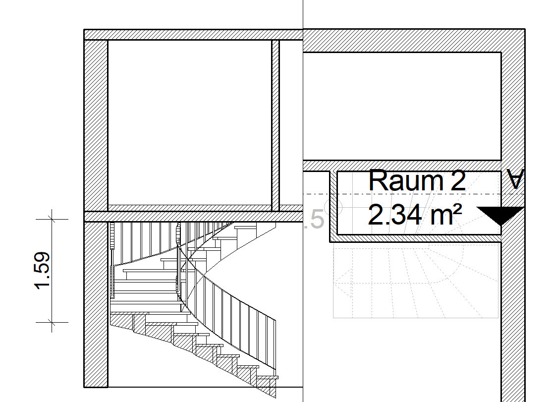

@goalkeeper .. you’re missing something here. On the ground floor, you have the storage room located under the upward flight of the stairs. The small storage closet is right by the entrance, standing full height, and it gets lower towards the back.
And this is what it looks like on the upper floor ... floor plan showing the storage space above the rising stair flight and a corresponding cross-section:
goalkeeper4 Jan 2020 19:05kbt09 schrieb:
@goalkeeper .. now you’re really missing the point. On the ground floor, you have the storage room located under the staircase going up. The utility closet is just at the entrance, standing at full height, and it gets lower towards the back.
And this is how it looks on the upper floor ... floor plan with the storage room above the staircase and a cross-section:
I’m still confused: so this would work now, right?
