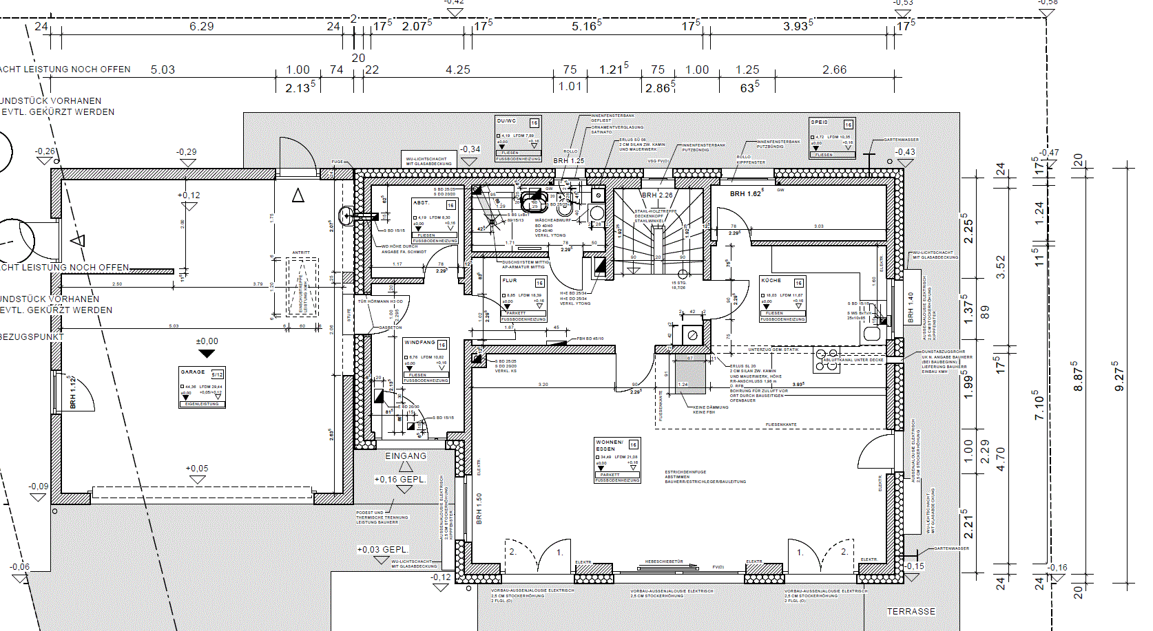

we are planning to build a single-family house with a basement and a double garage this year.
The garage will be half a meter longer. Therefore, the cloakroom will also be 0.5m (1.6 feet) longer than shown here.
What do you think of the design?
Thank you very much for your suggestions.

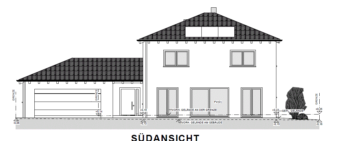

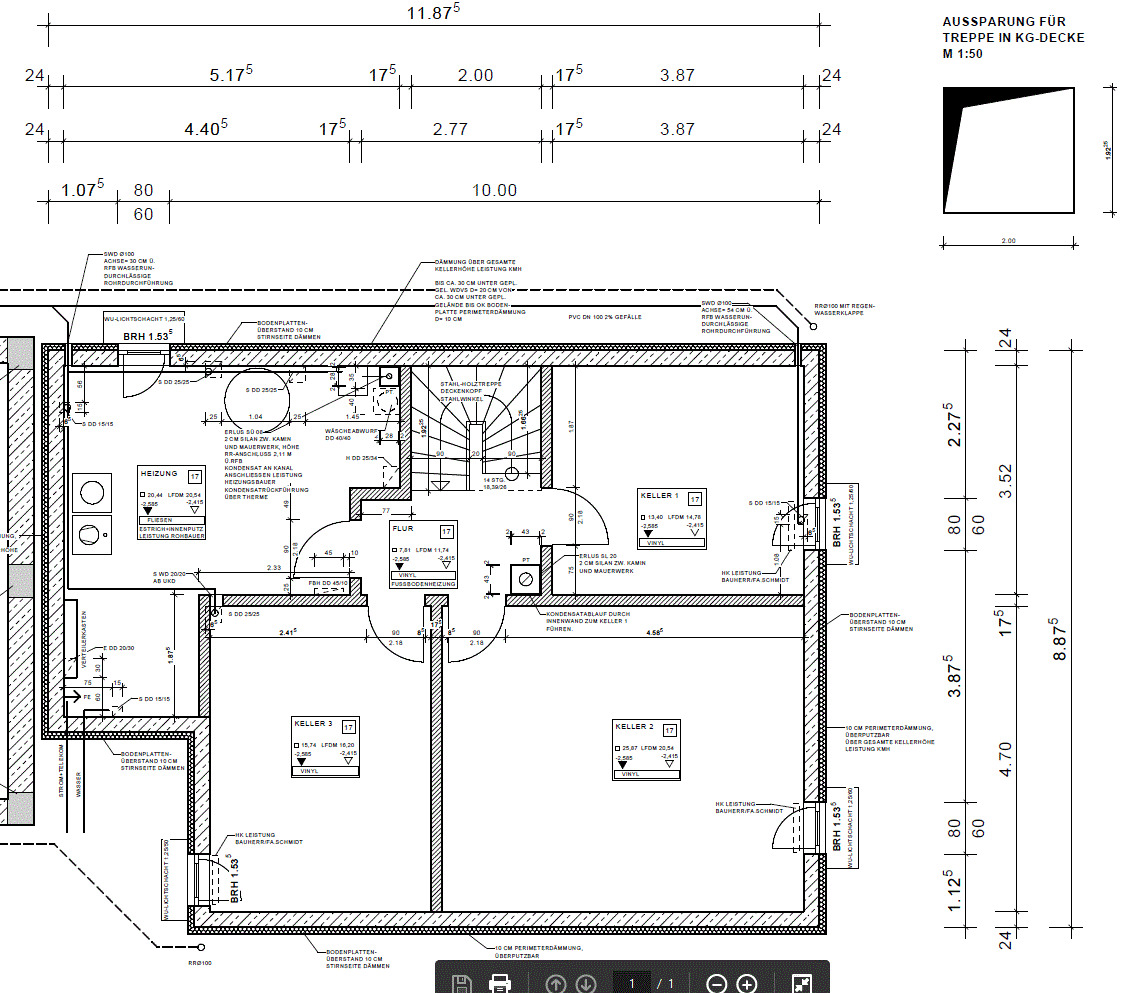

We have now completed our planning. As promised, here is our final floor plan. We gratefully took some suggestions from the forum into account and revised the plan.
The house is now slightly wider, which allowed us to widen the kitchen and the bedroom by 30 cm (12 inches).
In the entrance area, we removed the concrete ceiling to gain more height in the room.
We discussed the comment regarding the pantry and decided to keep it. We will install built-in shelves with the depth of beverage crates and still have a passage of about 80–90 cm (31–35 inches).
Unfortunately, we had to completely redesign the garage because the terrain slope resulted in a garage height of 3.35 m (11 feet), which required us to maintain the required setback distances.

kaho67422 Aug 2019 11:56
I think it’s quite good. Okay, there are a few things I would do differently, like adding a window in the walk-in closet and another one in the bathroom, but it will be a nice house.
Wugler1978
22 Aug 2019 12:06
kaho674 schrieb:
I think it’s pretty good. Okay, there are a few things I would do differently, like adding a window in the walk-in closet and another one in the bathroom, but it will be a nice house.
The window in the walk-in closet was removed to prevent clothing from fading. Unfortunately, the bathroom window also had to be removed because we moved the garage, and now the garage roof is in the way.
