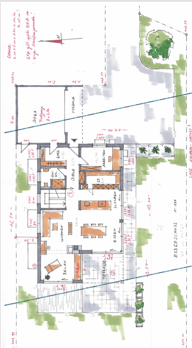

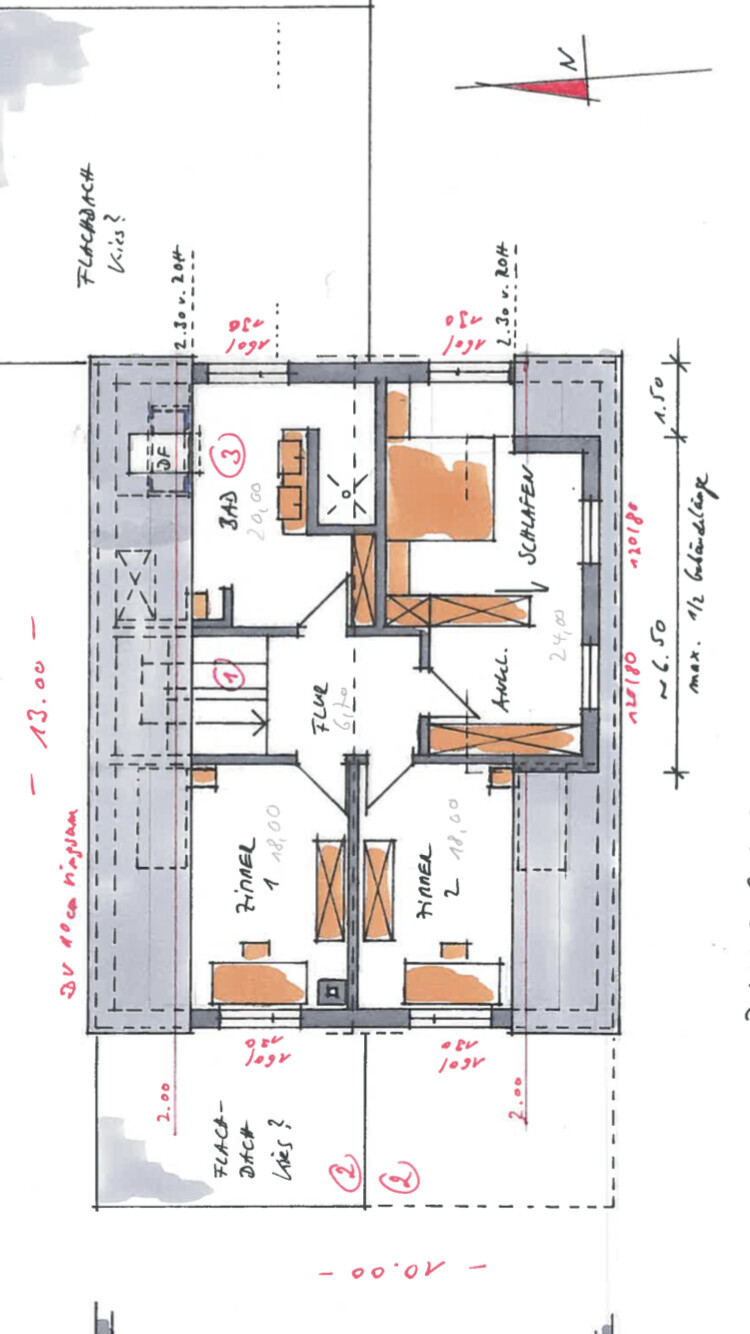

So everyone,
We have now received the architect’s first draft.
Attached are the initial “preliminary drafts” from the architect.
We have, of course, already communicated some initial change requests and ideas. But this is the current version on paper.
Anyone interested is warmly invited to share their thoughts!
We are not entirely sure what to make of it—especially the attic floor. Also, would a house that is 2 meters (6.5 feet) wider, meaning 12 instead of 10 meters (39.4 instead of 32.8 feet) from north to south, make the space planning easier and give a more “generous” feel…
Thanks in advance and
