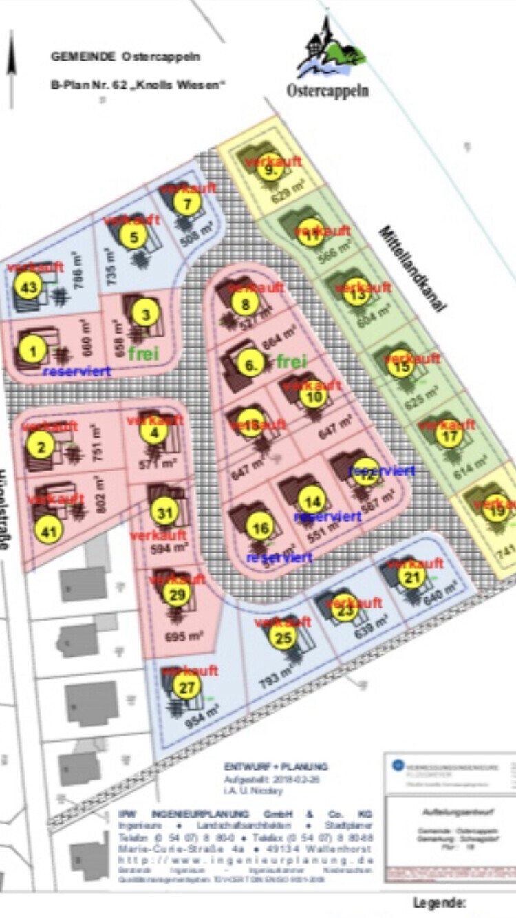

So, how is the house going to be positioned on the plot? Driveway from the east?
Is there no building envelope for the house? What are the dimensions of the plot? Will the neighboring plots be developed as shown?
First floor .. bathroom and dressing room are both not well planned.
Ground floor .. always consider the path from the source (kitchen) to the garden. Here it also seems to end up as a zigzag.
kbt09 schrieb:
Is there no building envelope for the house? Yes, Kerstin, it is marked – free pass 🙂
kbt09 schrieb:
And how is the house supposed to be positioned on the lot? Driveway from the east? Yes, this question was still unanswered from the last thread.
This was a quick estimate for approximate pricing. Nothing about the floor plan is really planned yet; it’s just rough ideas and preferences.
Due to the holidays, we haven’t been able to check where the sewer shafts are located, and that will ultimately determine whether the house should be positioned on the east or west side.
