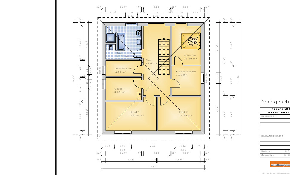

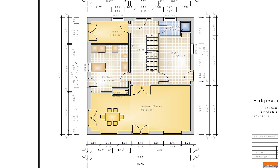

So, we have reconsidered the really useful tips. The result is the exchange of the guest room and the office, which enlarges the dining area. The kitchen is now changed to an L-shape. Although we originally didn’t want a corner layout, it seems we probably have no other option (or do you have another idea?). The sliding door between the kitchen and dining room is now also correctly shown as a passage.
What do you think?
DG-Grundriss: Flur, Bad, Abstellraum, Gastzimmer, Kind 1, Kind 2, Schlafen, Kleiderschrank, Treppe.
Grundriss Erdgeschoss: Wohnzimmer/Essen, Küche, Arbeitszimmer, Bad und Hauswirtschaftsraum.
17 Jun 2017 14:05
Keep an open mind about where the kitchen door will be and visit a kitchen showroom.
I see the door further up on the plan, about 70cm (28 inches) from the wall leading to the study.
Best regards, Yvonne
kbt09
17 Jun 2017 15:17
@ypg ... this will all be difficult because a side-by-side refrigerator is also desired .. my little red rag
17 Jun 2017 21:27
kbt09 schrieb:
@ypg ... this will all be difficult because a side-by-side refrigerator is also desired .. my little red flag
Mine as well – you end up designing a kitchen around an oversized energy guzzler.
Regards, Yvonne
Nordlys
17 Jun 2017 22:00
Side-by-side? Probably a huge two-door refrigerator in matte silver, with an ice maker, I guess. Cool appliances if you already have everything else. Karsten
