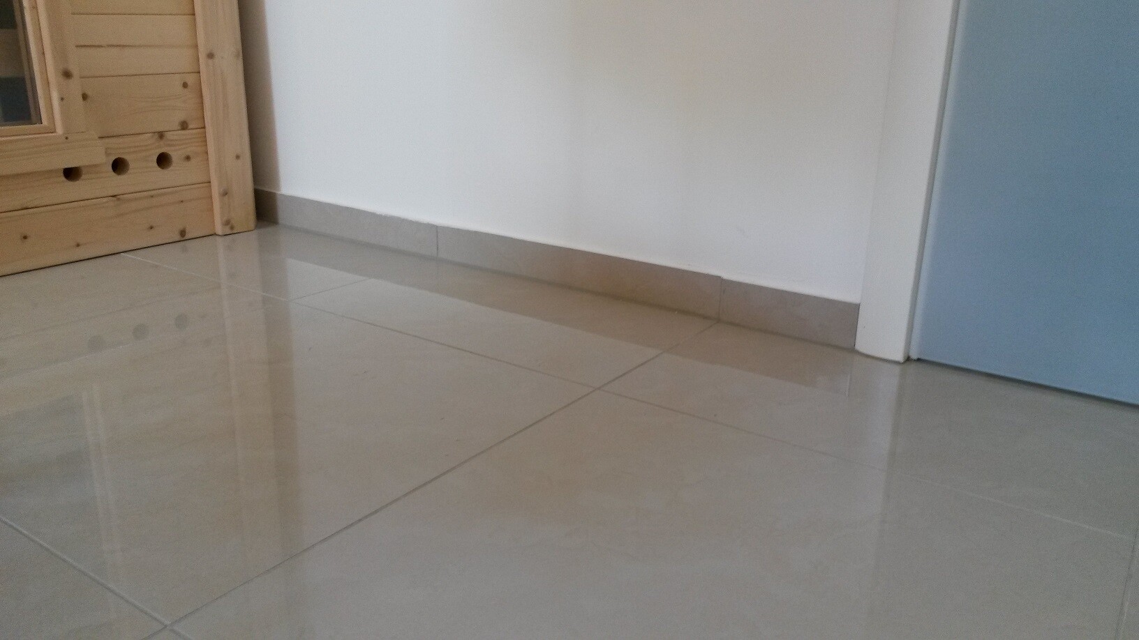

Doc.Schnaggls30 Aug 2016 12:06Hello,
throughout the entire ground floor – except for the (guest) bathroom – we had uniform porcelain tiles installed.
Our construction company offered us the options of wooden baseboards (standard) or base tiles matching the floor tiles (for an additional cost).
In the end, we chose the base tiles because we simply liked them better.
As mentioned above, you can of course cut the baseboards from offcuts of the floor tiles, but in our opinion, specialized base tiles just look better.
This is how it looks in our finished home now:
Regards,
Dirk
