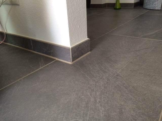

we had the same porcelain tiles installed throughout the entire ground floor, except for the (guest) bathroom.
Our builder offered us the option of wooden baseboards (standard) or base tiles matching the floor tiles (for an additional cost).
In the end, we chose the base tiles because we simply liked them better.
As mentioned above, you can of course cut the baseboards from leftover floor tiles, but in our opinion, specially made base tiles just look better.
This is how it looks now in the finished state:

What exactly is the difference between base tiles and self-cut baseboards?
Doc.Schnaggls
1 Sep 2016 14:09
Tiles cut on site may show slight to noticeable variations in color and/or texture along the top edge—which becomes visible—if the tiles are not fully dyed through or as a result of the cutting process.
