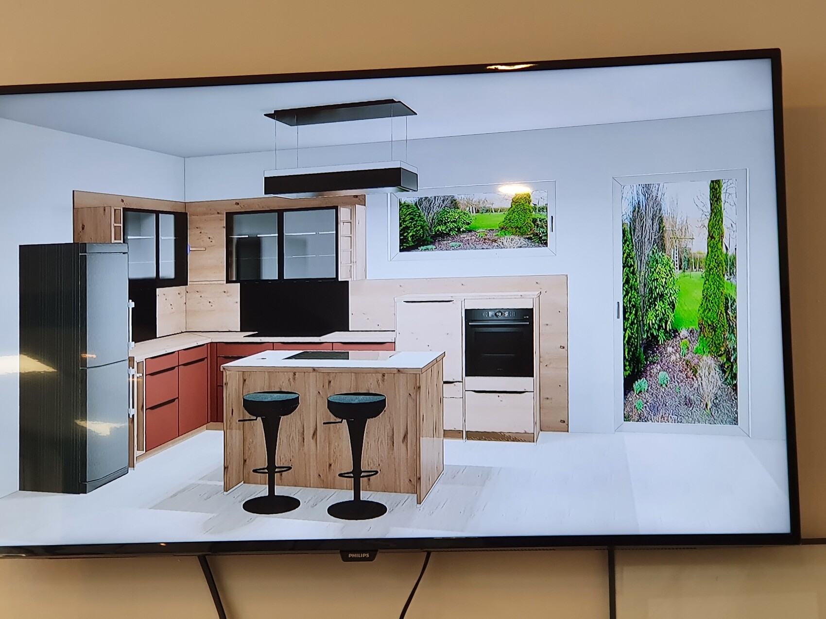

thoughtless8628 Jan 2021 19:07The kitchen is fully planned and has more than enough storage space. See the illustration. It’s currently just the 3D rendering, but you can get a good idea of the layout. And no, the dining table is not blocking the walkway to the terrace—I’ve drawn everything to scale at home, so that’s not an issue. I will reconsider the idea of a small adjacent cloakroom. However, I definitely do not need a second shower.
Is the countertop the entire table? I don’t see any other space.
