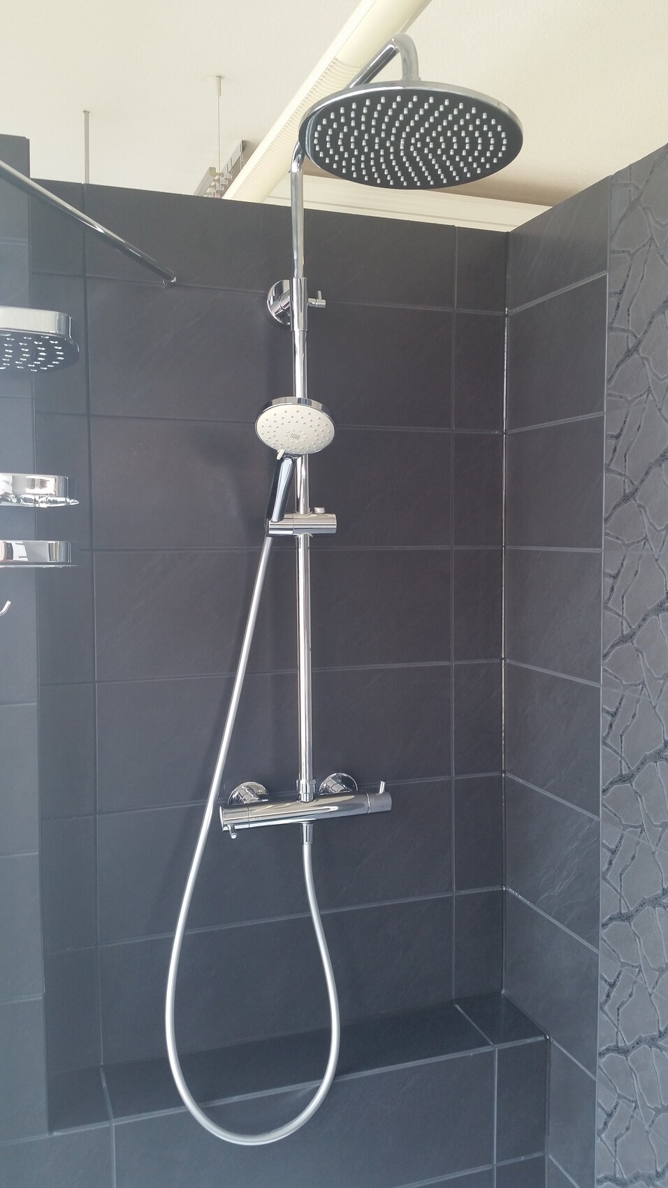

I also think a 67cm (26 inches) glass panel is sufficient... however, I would avoid placing a rainfall showerhead directly in the middle of the shower area.

HausMatt
6 May 2019 06:55
kbt09 schrieb:
Do not install a rain shower head in the middle of the shower area.
Well, the fittings are planned to be on the upper wall. The planned shower head can be seen in the attachment.
