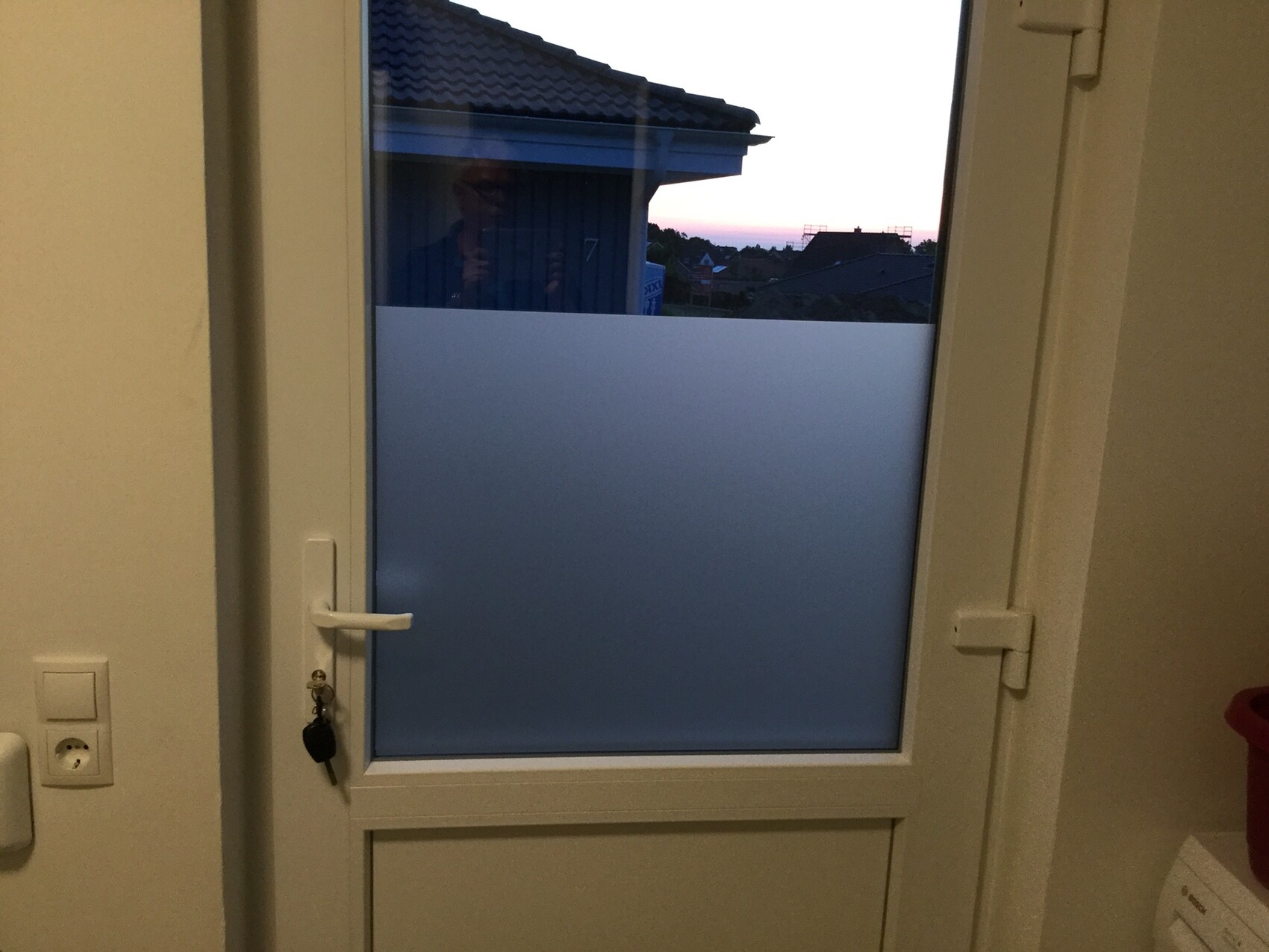

Nordlys
22 May 2018 21:48
Hmm, in new buildings from 2018, these are typical back doors. They are made of plastic, glass, and foil.
Door with frosted glass, interior view, looking outside at roofs in evening light
