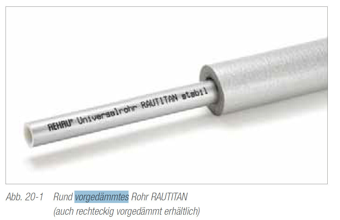

The pipes are pre-insulated Rehau Rautitan pipes. However, the connectors (plastic) are not insulated.
The insulation consists of closed-cell PE foam with a co-extruded, moisture-resistant PE film (see also photo).

I'm not an expert, but the insulation looks rather thin. I couldn't quickly find any datasheets.
wrobel16 May 2016 10:34
Hello
I’m not exactly sure how this is done in Austria, as I have always done it the way it is done in Germany.
The insulation thickness seems to be only 50% of what it should be. This is definitely not sufficient for pipes that carry hot water.
