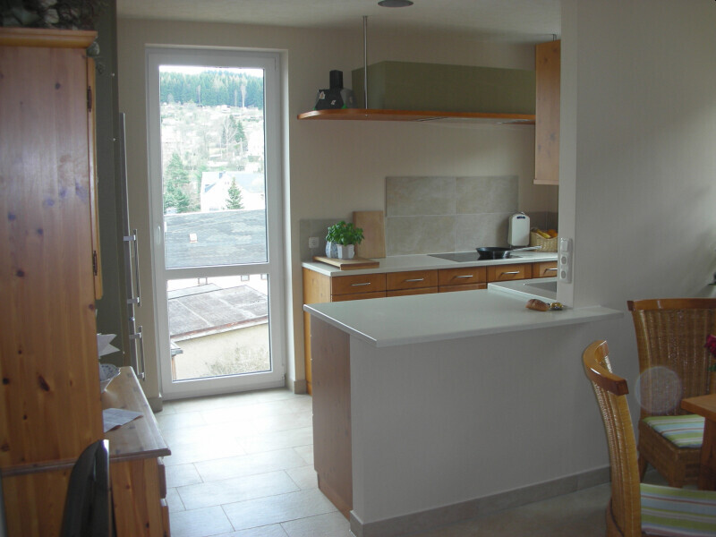

I have had a patio door in my rental apartment for 12 years (the photo is old, back when the terrace was still under construction). The door is about 240-245 cm (94-96 inches) tall, and the door panel is approximately 95 cm (37 inches) wide.
There is a glass-dividing mullion, and the hardware is holding up, but you can clearly feel when opening the door that this panel is taller than usual.
