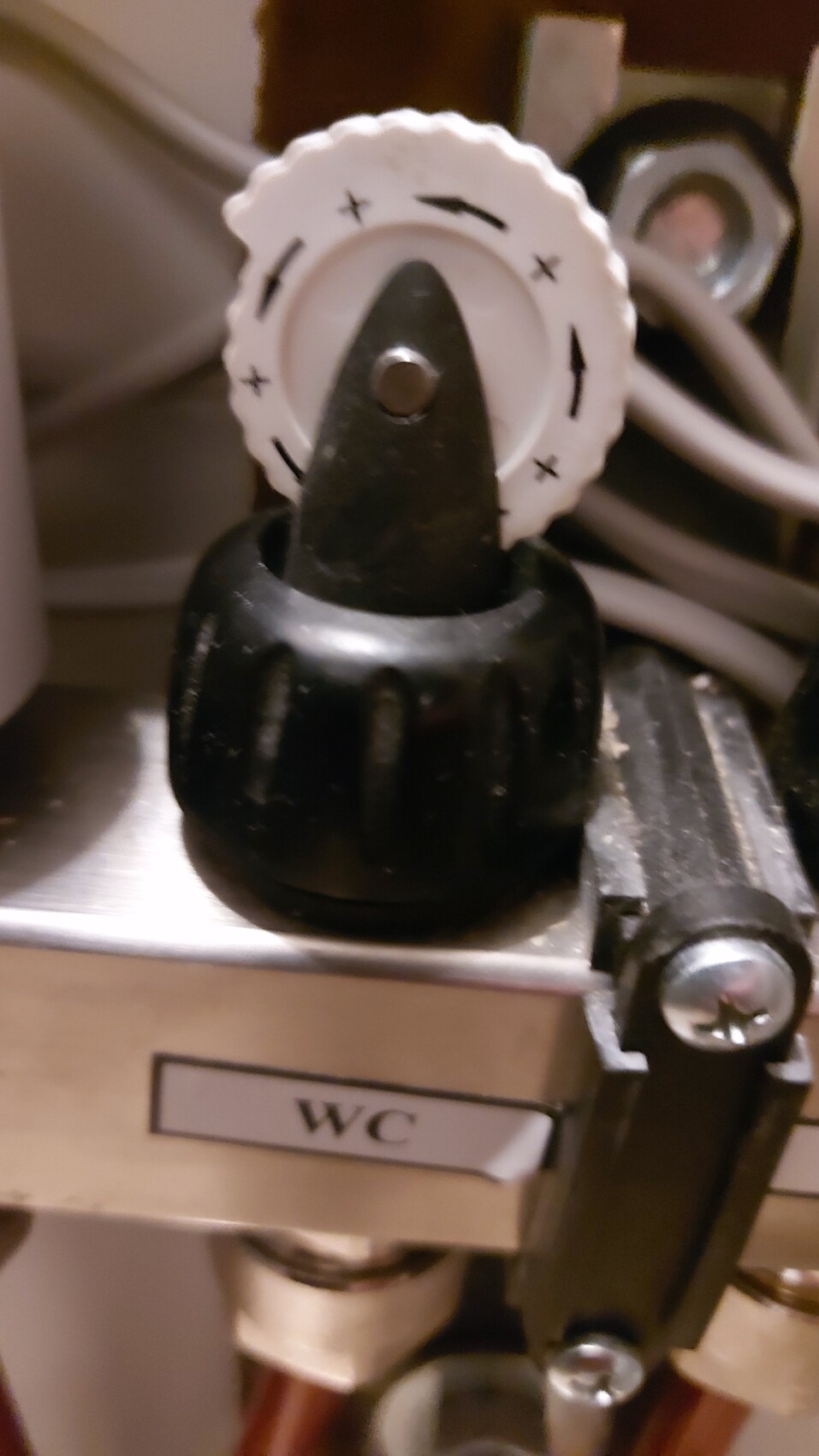

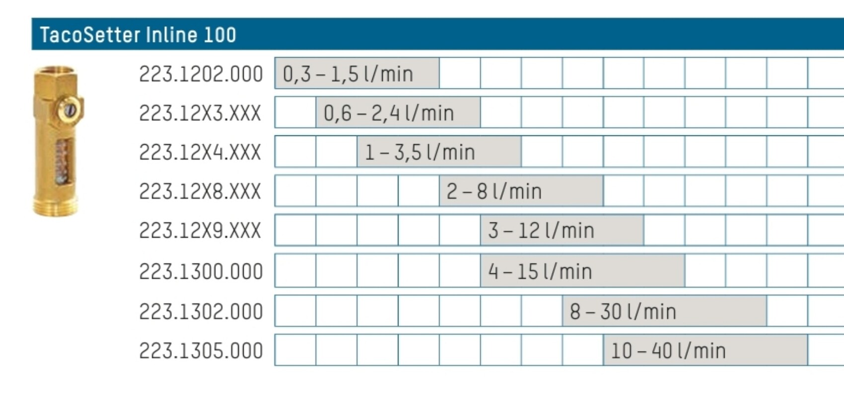

That’s why many thermostatic radiator valves also appear to have zero flow according to calculations. At 20°C (68°F), I can barely get any adjustable flow, and in reality, since I want only 18-19°C (64-66°F), it’s even less. You still don’t understand how the underfloor heating system works.
Finally, give the "unit" the volume flow it needs.
I have now assigned the volume flow rates to the list:
Kitchen 1: 65 m (213 ft), 1.0 L/min
Kitchen 2: 54 m (177 ft), 1.1 L/min
Living/Dining 1: 117 m (384 ft), 0.8–0.9 L/min
Living/Dining 2: 91 m (299 ft), 1.0 L/min
Living/Dining 3: 97 m (318 ft), 0.9 L/min
Bedroom 1: 101 m (331 ft), 0.9 L/min
Bedroom 2: 98 m (322 ft), 0.9 L/min
Bathroom: 73 m (240 ft), 1.0 L/min
Guest 1: 77 m (253 ft), 1.0 L/min
Guest 2: 71 m (233 ft), 1.0 L/min
Hallway 1: 37 m (121 ft), 1.1 L/min
Hallway 2: 35 m (115 ft), 1.1 L/min
WC: 39 m (128 ft), 1.0 L/min
Utility room: 49 m (161 ft), 1.0 L/min
According to the heat pump display, the current flow rate is approximately 768 L/h (203 gal/h).
Heating curve set to 0.1.
Desired temperature is 20°C (68°F).
Now it just needs to get colder again.

lesmue79 schrieb:
According to the heat pump display, now about 768 L/h (202 gallons/hour)
Heating curve 0.1
Desired temperature 20°C (68°F)See, it works after all. You can reduce the sleeping temperature to 0.5 each and add 1 liter (0.26 gallons) in the bathroom.
Have you checked the heating curve in your documents?
What output is delivered at 0.1 / 20 with an outdoor temperature of 0°C (32°F)? That’s probably too little.
What are the room temperatures currently?
