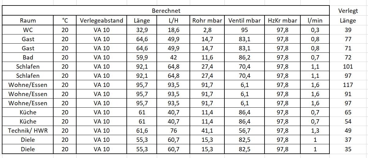

Hausbau 5525 Oct 2021 11:34Hello Lesmue, according to your table, a flow rate of 14.3 liters per minute = 858 liters per hour was calculated. Are you still below the maximum possible flow rate of the heat pump with this value? After your throttling, you are below 500 liters per hour. That is a really significant reduction in flow rate. Can you comment on that? Or are my numbers not correctly represented?
It was close to 0 degrees Celsius (32°F) early on here. What heating load/heating output was achieved at that time? How far did your heat pump (Vaillant Arotherm Split 3.5 kW) reduce its output?
The problem is that it is a standard general contractor / prefab house provider design. The heating load is calculated at 3.2 kW at -12°C (10°F), but there is an inherent error because the controlled mechanical ventilation was not included in the heating load calculation.
Transmission losses are 2424 watts, plus 752 watts of ventilation losses, totaling 3176 watts. Assuming a heat recovery efficiency of 70% in the controlled mechanical ventilation, the ventilation loss reduces to 225 watts, which means the total heating load would be only 2649 watts.
The underfloor heating is of course designed for the full 3176 watts, although this includes rooms calculated at 20°C (68°F) that are actually intended to reach only about 18-19°C (64-66°F) (bathroom, guest room, bedroom, hallway).
The utility room can be completely excluded because it is already too warm due to external heat sources (inverter, heating circuit distributor, etc.) despite the underfloor heating being switched off.
Accordingly, the actual volume flow is lower than the calculated value.
The fact that the floor heating design is primarily for foot comfort is shown by the bathroom circuit; how exactly are you supposed to set 0.3 liters per minute on a Tacosetter valve? The calculated flow velocity in this circuit is actually 0.0 m/s.
In the guest room, at 0.8 L/min, it is 0.1 m/s. The system is designed for a maximum supply temperature of 30°C (86°F).
That is why many Tacosetters appear as if they have zero flow according to the calculation. I already have almost no adjustable flow for the 20°C (68°F) setting, and in reality, since I want only 18-19°C (64-66°F), even less.
I have already mentioned that I fully closed the circuits once and then reopened them until a minimal resistance was noticeable. However, this is barely visible because the Tacosetters only reliably display flows from about 0.5 L/min.
