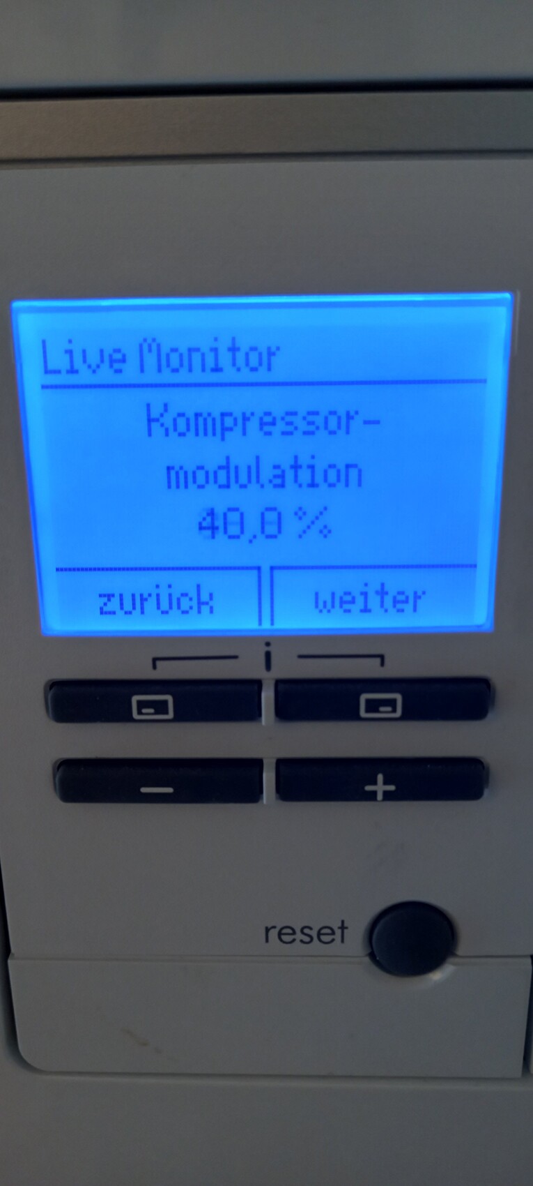

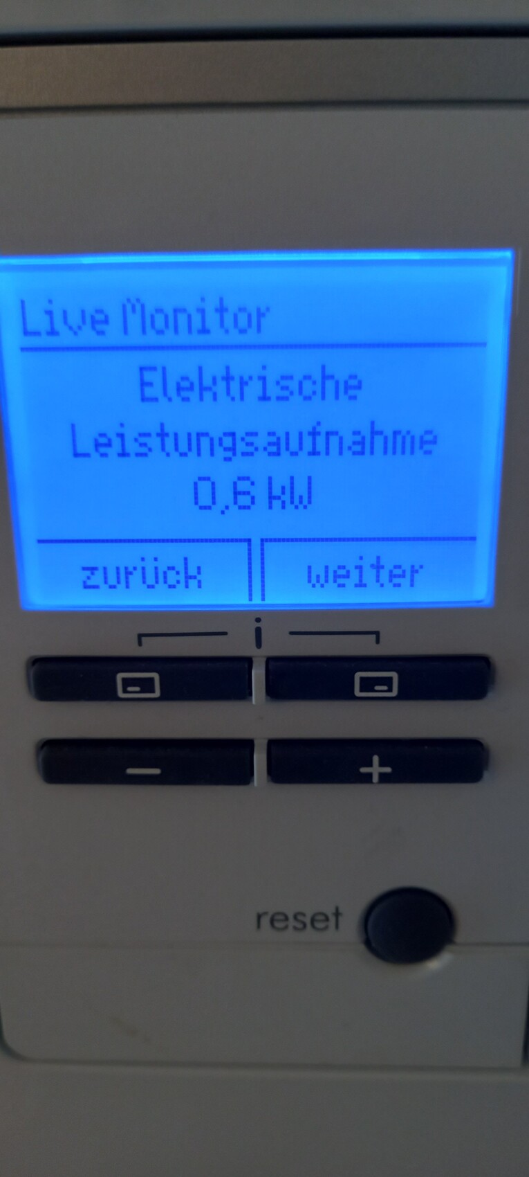

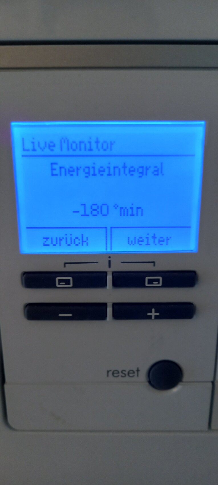

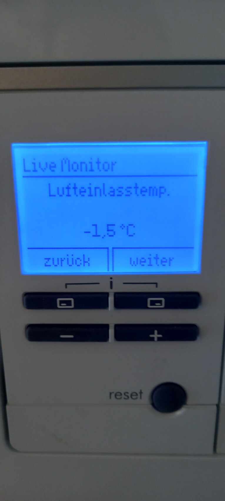

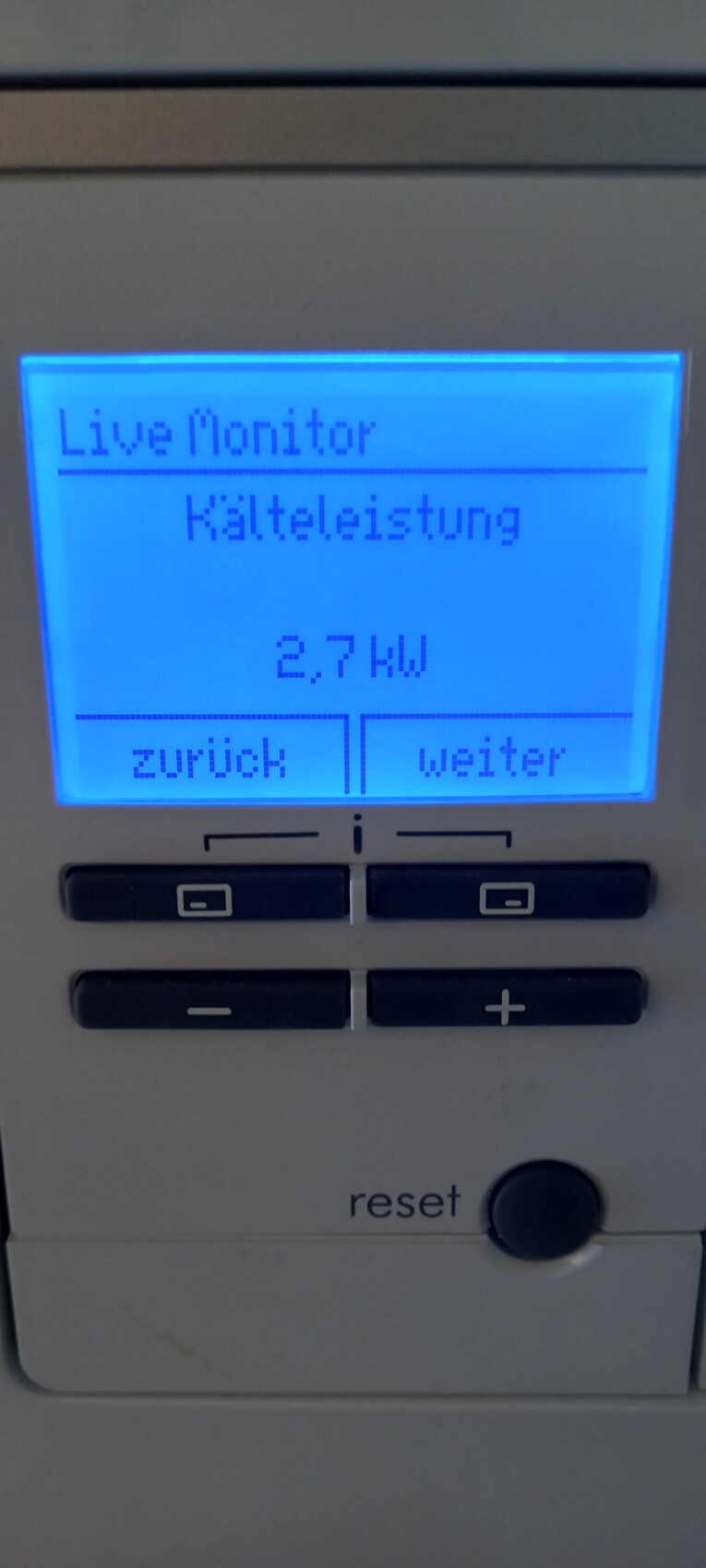

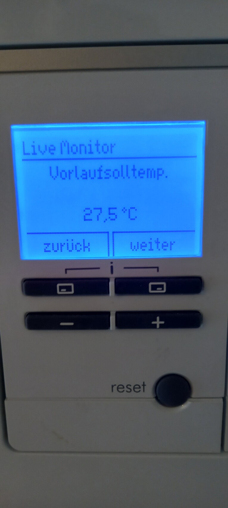

So, our Vaillant air-to-water heat pump now also runs through the night. I didn’t notice any defrosting last night. It only happened once this morning.
We usually have temperatures around 0°C (32°F). Now it’s dropping below freezing. During the day, I have set the temperature to 24°C (75°F) and at night to 22°C (72°F). On average, the indoor temperature is now about 23°C (73°F) in almost all rooms.
