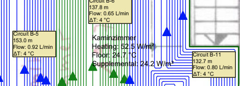

jens.knoedel18 Jan 2024 10:33Eldirwars schrieb:
Hydraulic balancing for the entire house. However, the head of the heating company did not adjust it according to any list or similar. The length in meters (feet) of each circuit’s piping was noted. Based on these lengths, he then set the flow between 0.8 and 2.0 liters (0.2 to 0.5 gallons). For example, 0.8 at 60 meters (200 feet), 1.5 at 120 meters (400 feet). So, in my opinion, it was all very imprecise. Very imprecise and just a rough estimate.
A more precise example looks like this:
