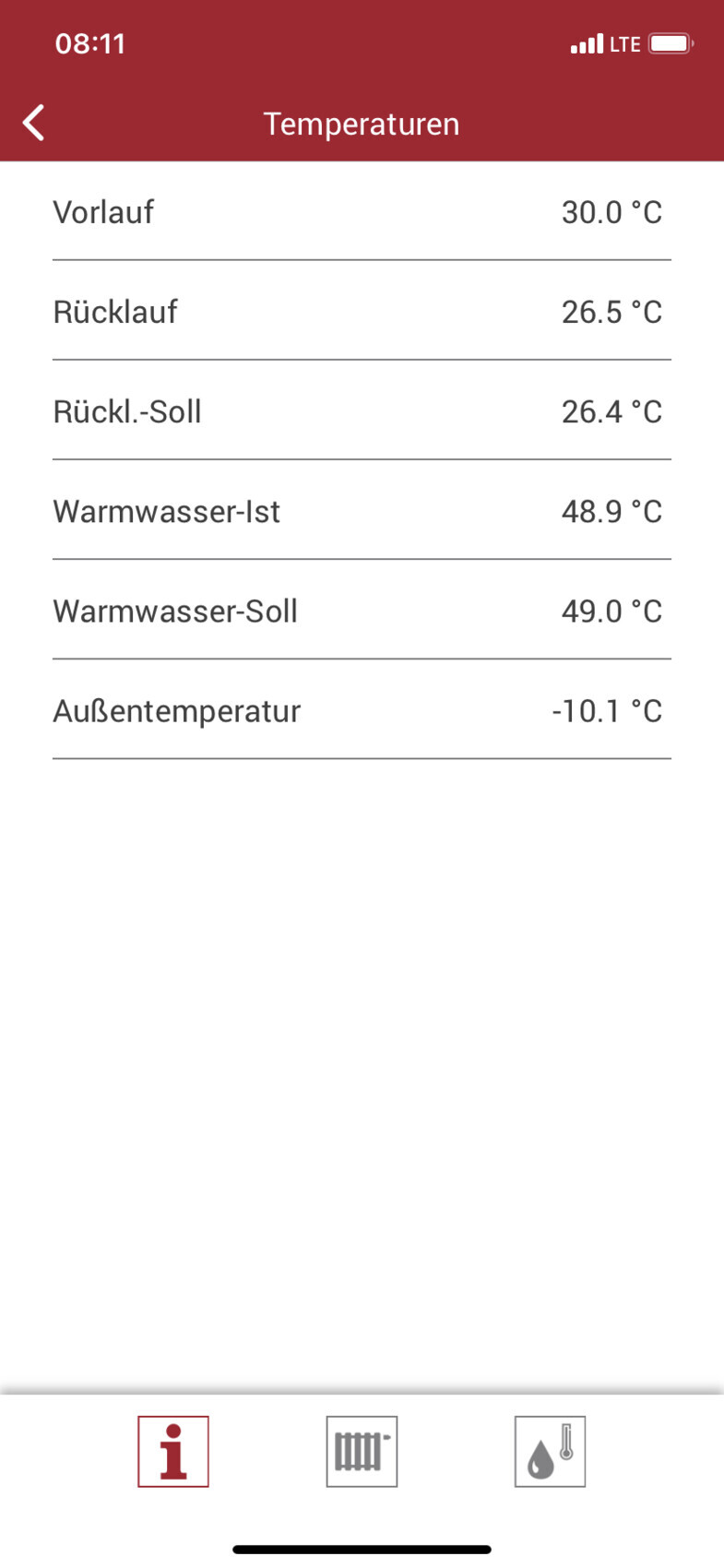

This morning, the heating system measured an outside temperature of -4.5°C (23.9°F) (Apple claims -6°C (21.2°F)) and is sending 30°C (86°F) into the supply line.
The unit was nicely frozen over.
I’m wondering what temperature I should set the bivalence point to. The default was something strange, like -7°C (19.4°F) or so. I have now set it to NAT.
OWLer schrieb:
This morning, the heating system measured an outside temperature of -4.5°C (23.9°F) (Apple claims -6°C (21.2°F)) and the supply temperature is set to 30°C (86°F).
The unit is nicely frozen over.
I’m wondering what temperature I should set for the bivalence point. The default was something strange, like -7°C (19.4°F) or so. I’ve set it to NAT for now. What heating curve are you currently using? Any offset?
OWLer schrieb:
I'm wondering what temperature to set the bivalence point to. The default was something strange, like -7°C (19°F) or so. I changed it to NAT. I would say it depends on how the system is designed.
If the maximum output of the heat pump is sufficient for NAT, there is no reason to set the bivalence point higher, right? Or do you even have some reserves?
I assume the second system is the electric backup heater. That's always less efficient than the heat pump.
