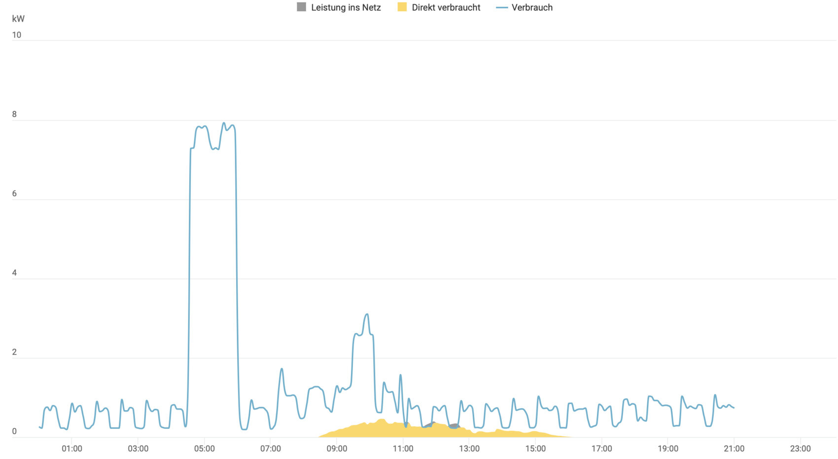

OWLer20 Nov 2021 23:37
guckuck2 schrieb:
15 starts per day – during the heating season – is not great but also not a disaster in my opinion.
Today I will probably have between 25-30 starts at 9-14°C (48-57°F) outdoor temperature. Let’s see if I can increase the energy integral even further.
Time series: Blue = consumption, Yellow = directly consumed; peak around 5:00 AM, low values.
Let’s see what happens in the next few days as temperatures continue to drop.
