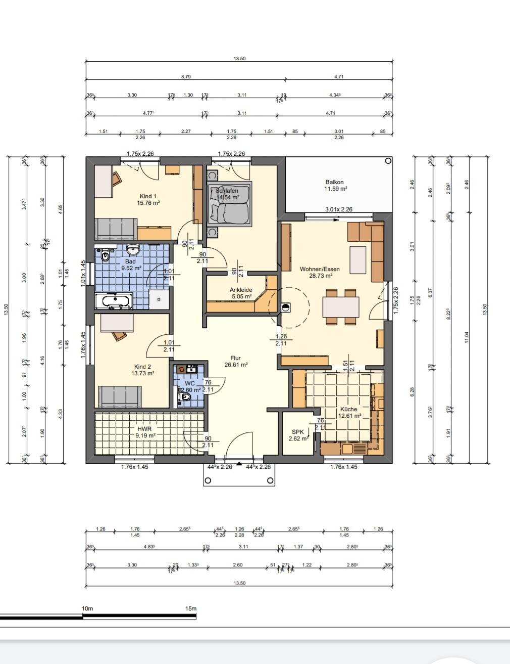

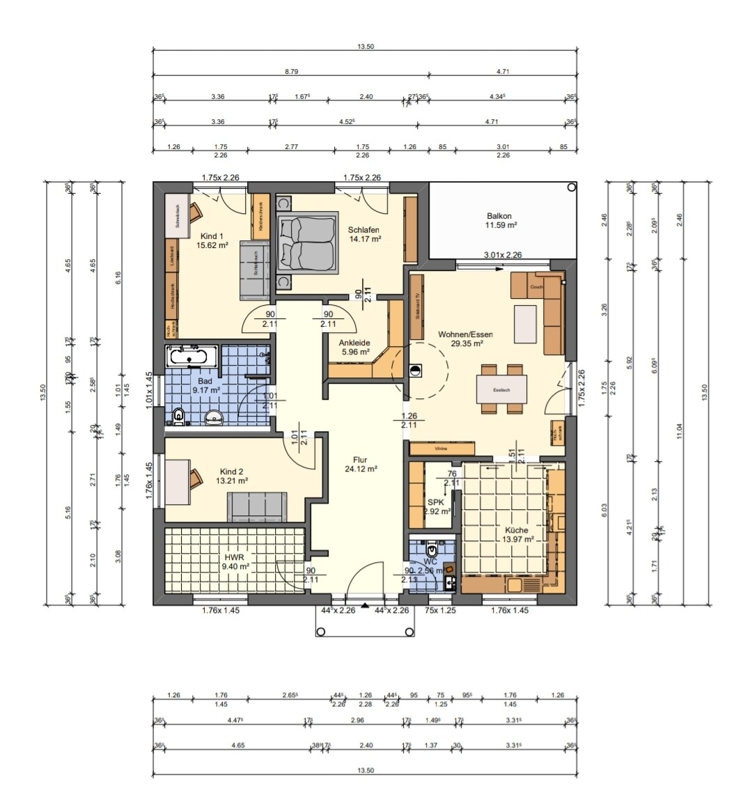

DaSch17 schrieb:
Sorry. I misunderstood. I thought the installments were split into two large payments... oops:
Then everything is fine No, no. I would never have agreed to that. The 5% is divided into two installments of 50% each. The construction contract then includes 13 installments.
Two designs are available for selection. The one with the guest toilet was suggested by the architect. We like it, but having to access the bedroom through the walk-in closet is a no-go for us.
The other design is the original one we started with. The furniture in the children’s and living rooms is ours and will be taken along since it is new.
What do you think?
What do you think?
R
RotorMotor25 Sep 2020 20:18Ybias78 schrieb:
..., but having to access the bedroom through the walk-in closet is a no-go for us.
What do you think?For me, that’s exactly what makes a walk-in closet useful in the first place.
What bothers you about it?
RotorMotor schrieb:
For me, that's exactly what makes a walk-in closet practical in the first place.
What bothers you about it? The fact that people/our daughter will have to walk from the terrace through our walk-in closet to get to the bathroom. We don't want the walk-in closet to be a passage room.
Ybias78 schrieb:
The fact that people/the daughter will walk from the terrace through our walk-in closet to get to the bathroom. We don’t want the walk-in closet to be a passage room.This is not clear from the plans... Is this the ground floor? But even then, it doesn’t make sense...rdwlnts schrieb:
The plans don’t show that... Is this the ground floor? But even then it doesn’t make sense...It’s a bungalow. Just accept that it’s a no-go for us, like a closed kitchen is for others, etc.
