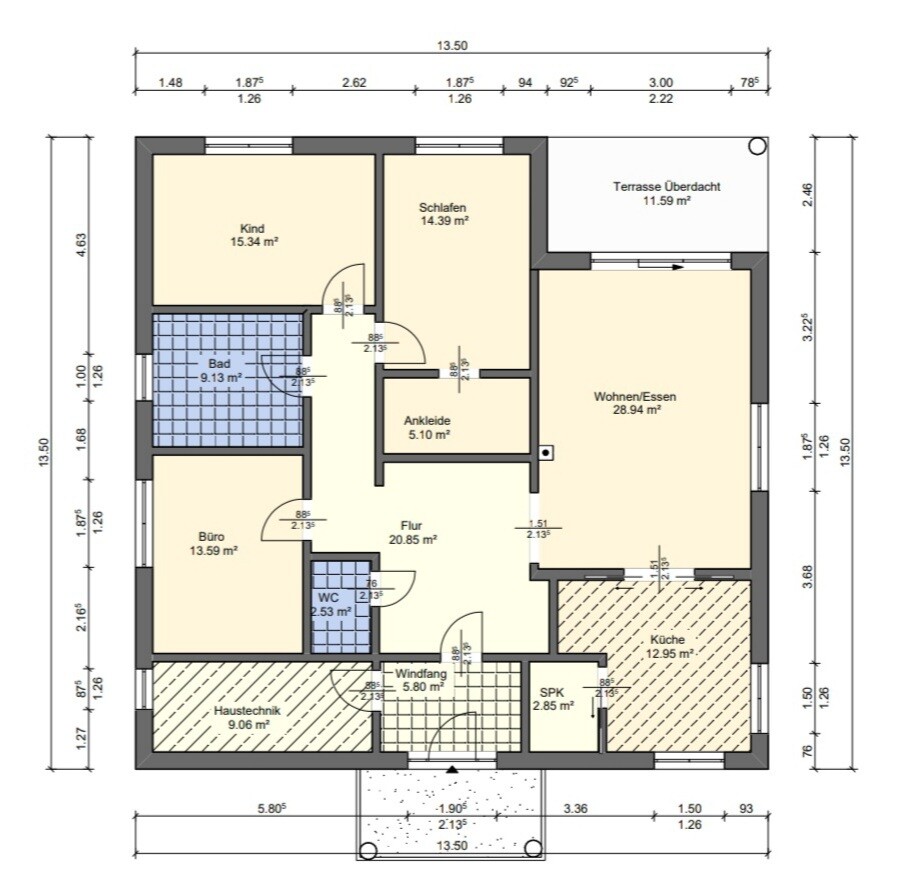

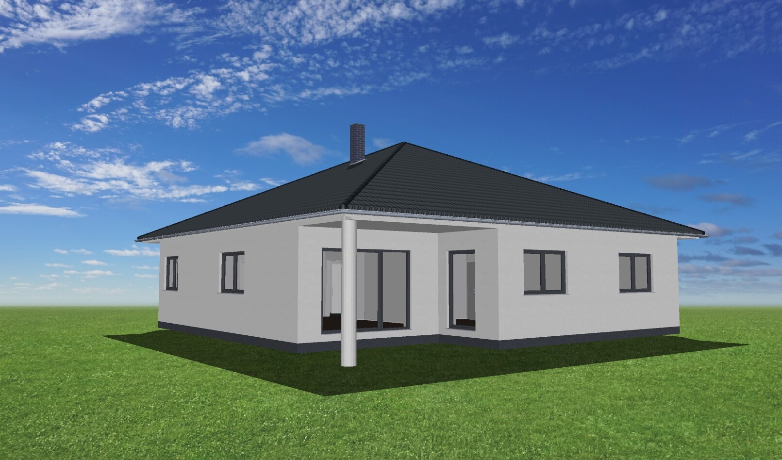

@11ant Here are the requested images related to the lift-and-slide door.
Floor plan of a house with kitchen, living room, bedroom, bathroom, office, hallway, covered terrace.
White detached house, dark roof, chimney, glass facades, standing on green lawn.
11ant18 Aug 2020 20:33
Ybias78 schrieb:
@11ant here are the requested pictures regarding the lift-and-slide door.
I don't see any reason to oppose the classic two-part lift-and-slide door.
Ybias78
19 Aug 2020 07:57
How do you see the covered terrace? It is on the south side. We are a bit worried that it might cast too much shade. We wanted to have bright rooms.
E
exto1791
19 Aug 2020 08:01
Ybias78 schrieb:
What do you think about the covered terrace? It’s on the south side. We’re a bit worried it might cast too much shade. We wanted bright rooms.
That corner will be shady. We had a similar plan but then decided against it. We visited two houses with such an overhang and clearly noticed that area gets a lot of shade. If you prefer bright rooms, I wouldn’t recommend it.
We also thought about it for a long time but will probably add a terrace roof later without building any walls or creating an overhang.
Ybias78
19 Aug 2020 08:06
exto1791 schrieb:
This corner will be shaded. We had a similar idea planned but consciously decided against it. We visited two houses with such a “projection,” and it was clear that this area received a lot of shade. If you like bright rooms, I wouldn’t recommend it.
We also thought about it for a long time, but later on, we will probably add a patio roof rather than building a wall or creating a “projection.”
We still have a floor-to-ceiling window on the southwest side. The rooms also have a ceiling height of 2.80 m (9.2 ft) measured from the finished floor. We might try to see something like this in person.
