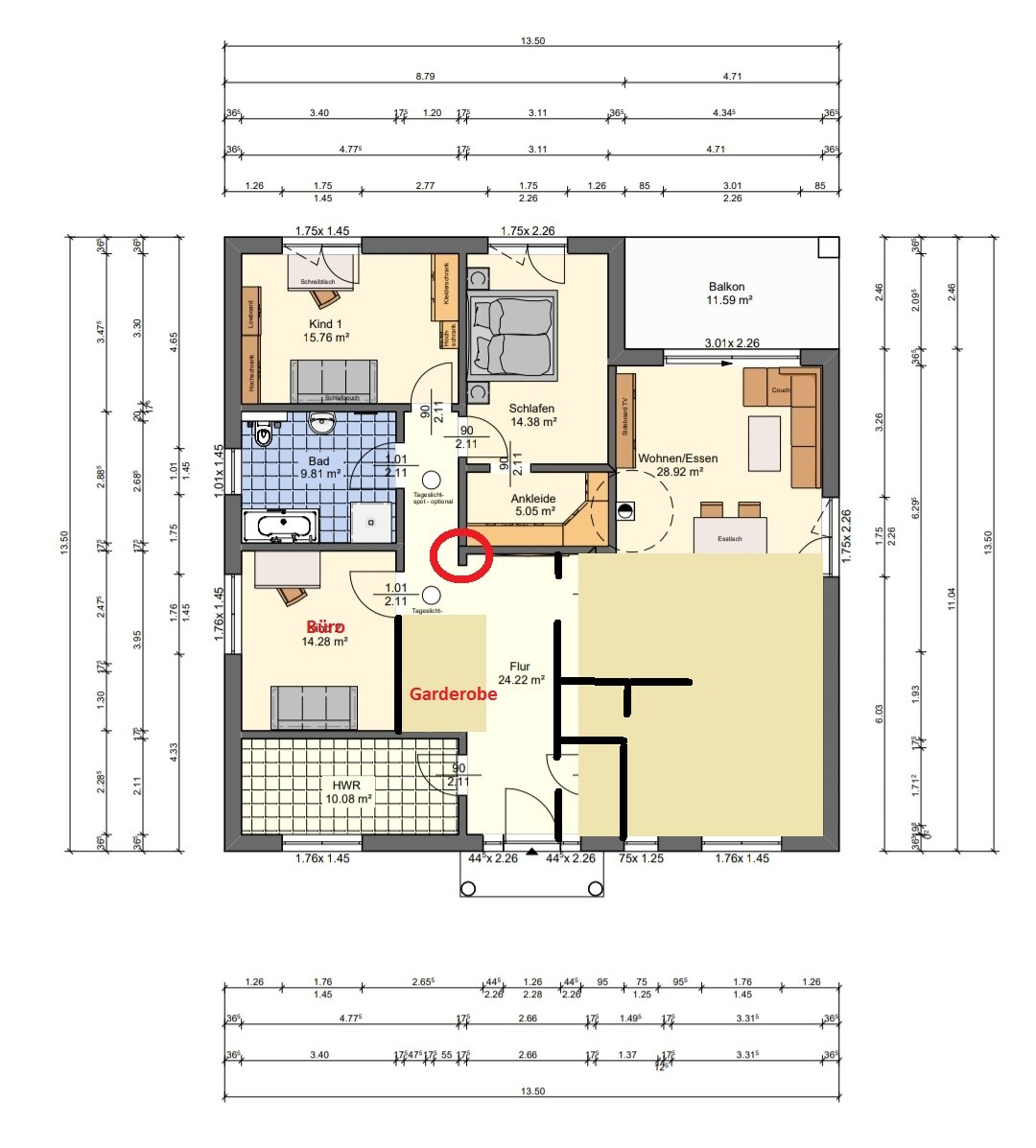

DaSch17 schrieb:
Ah, okay. I was missing the information about the plot width. But even then, in my opinion, it’s even less clear why a corridor of 2.66 m (8 ft 9 in) is allocated on a width of 13.50 m (44 ft 3 in).
Where is southwest on your plan? What is the purpose of the upper/lower wall at the bottom left between the utility room + children’s room and the corridor? South is where the balcony, meaning the covered terrace, is. The entrance is on the north side.
There are three of us, not four. It is called the second children’s room because the general contractor doesn’t want to talk to the building authorities about commercial use if we name it office/guest room. Also, when we had friends with two children in our 70 sqm (750 sq ft) apartment, we missed having a second shower. So, the house will not have one either.
We will still consider the corridor being too large.
pagoni202028 Sep 2020 15:47Ybias78 schrieb:
And even when we had friends with two children staying in our 70sqm (750 sq ft) apartment, we missed having a second shower. So it won’t be included in the house either.Bob Dylan said, “The times are a-changin’”... Of course, it’s your house; I just want to share a thought because I found myself in the same situation with my first house and wished I had made a different choice 20 years later. Whether it’s resale value, a changing life situation, or something else, I think having a second shower in a home takes little space but can offer great benefits—or at least the option to add one later on. As you mentioned, you had 70sqm (750 sq ft) before and it worked, but now you’ve expanded to 140sqm (1,500 sq ft). Having either one bathroom or an extra shower is fine—both options are possible. However, if your (still young) child grows into a 2-meter (6 ft 7 in) tall person or a young adult, and you later have regular visitors of a similar age... well...
Just a quick note:
- If you reduce the hallway by one side panel, you gain significantly more space in the kitchen and can position the table closer to the kitchen area. This also frees up more room in the living area.
- The second child’s room used as an office wouldn’t really need a closet niche and would become much more compact. This impractical U/T-shaped wall can then be removed, allowing for a nicely placed wardrobe that’s not immediately visible.
What is the purpose of the wall outlined in red? It seems very inconvenient for the walking path around the corner. I would leave it out.
pagoni2020 schrieb:
Bob Dylan said, "The times are a-changin".....
Of course, it is your house, but I just want to point out that I made the same decision with my first house and wished I had corrected it 20 years later.
Whether it’s resale value, changing life circumstances, or whatever else, I think having a second shower in a home takes up little space but can offer great benefits – at least having the option to add it later.
As you wrote, you had 70 sqm (750 sq ft) and it was fine, but then you increased it to 140 sqm (1,500 sq ft). It’s fine to have one bathroom or an extra shower; both are possible, and there are many options.
However, if your (currently small) child grows into a 2-meter (6 ft 7 in) tall young adult or a young woman, and you also have frequent visitors of similar age...... hmm...... You are partly right. However, we decided to see what we miss in the apartment and then implement those features in the house. A second shower was never on the list.
DaSch17 schrieb:
Just a quick thought:
- If you reduce the hallway by one side panel, you’ll have significantly more space in the kitchen and be able to position the table closer to the kitchen area. This will also free up more room in the living area.
- The second bedroom used as an office wouldn’t really need a closet niche, making it much more compact. This impractical U/T-shaped wall can be removed, allowing for a nicely placed coat rack that isn’t immediately visible.
What is the purpose of the wall outlined in red? It seems very impractical for the walkway around the corner. I would leave it out. Similar topics
