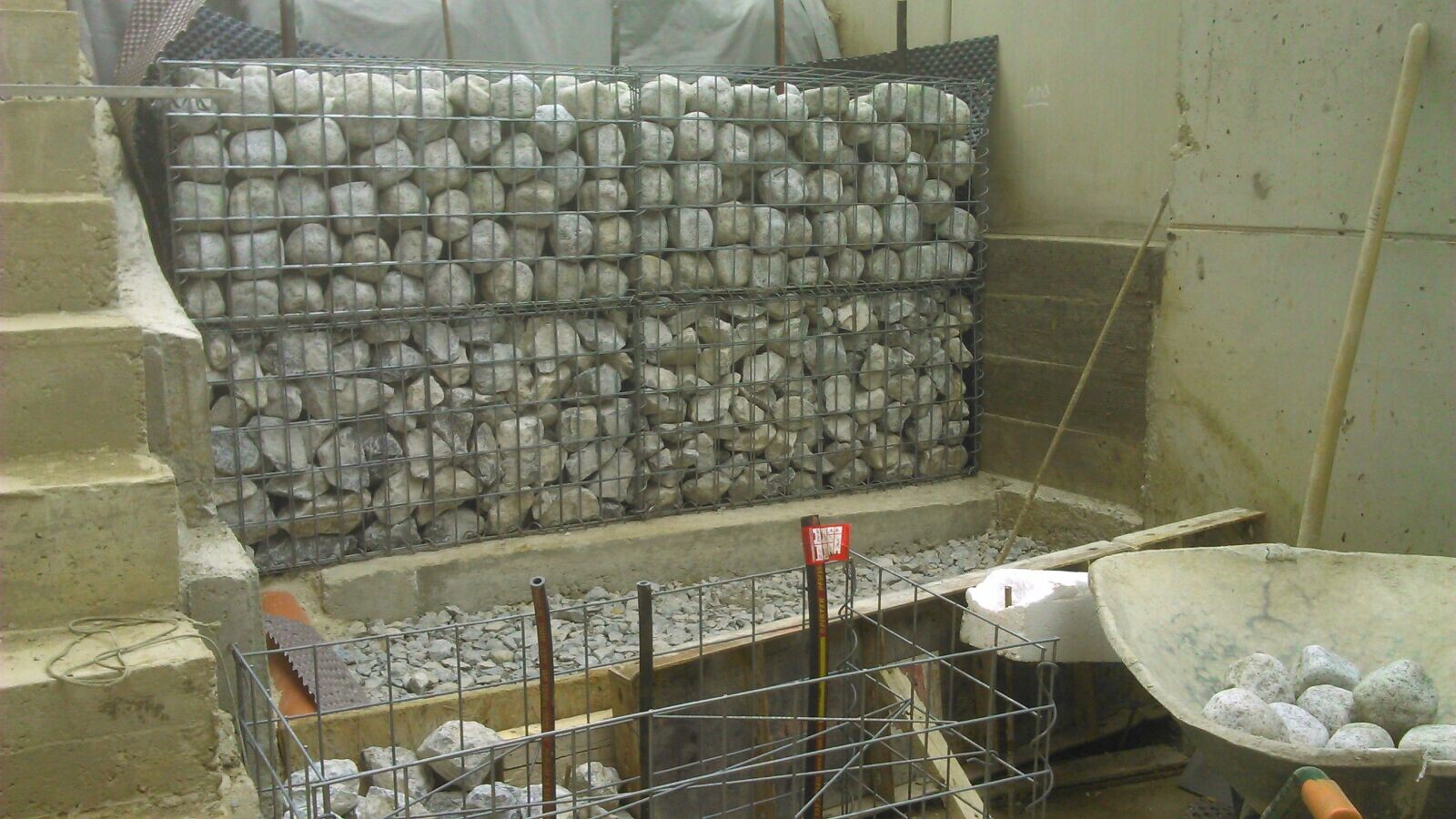

We also installed gabions on one side, including the base layer. According to the landscape gardener, it should have cost around 2.5 tons (2.5 metric tons), but we bought four used and two more new ones, and including the filling material, it came to just under 500 euros. Here’s a picture, but on that side it would have been too expensive because those are the higher sections and you wouldn’t even see the wall...
