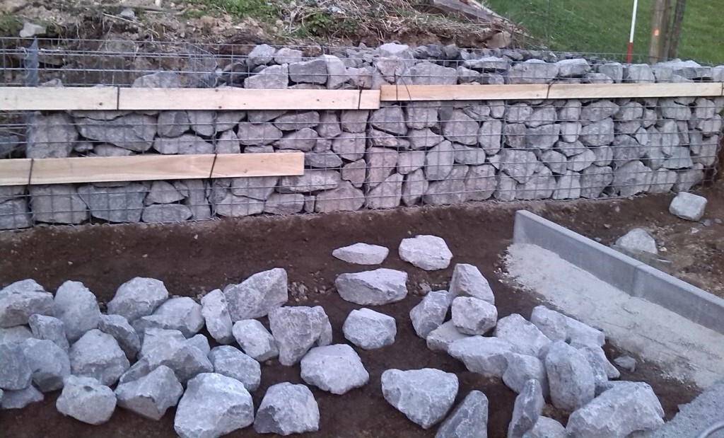

Gabionenwand aus Steinblöcken mit Holzbrettern darüber; lose Steine auf der Baustelle.
A depth of 70 cm (28 inches) was excavated and backfilled with 10 tons of lava rock, sized 0-45 mm (0-1.8 inches), then compacted. The wall is 13 m (43 feet) long and 2 m (6.6 feet) high. The curve, made of basalt like the gabion fill, measures 6 m (20 feet) and ranges in height from 1.5 m (5 feet) to 0.3 m (1 foot).

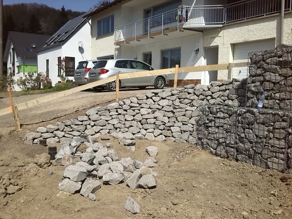

and here is the curve:
Construction site in front of residential house: gabion retaining wall, wooden railing, cars in driveway, pile of stones.

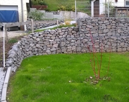

And this is how it looks today
Garden with stone retaining wall, lawn, and small tree

Looks great!
