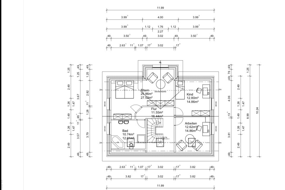

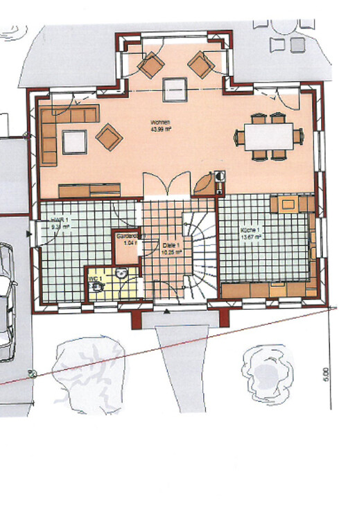

Häuslebauer154 Aug 2015 11:42Hello everyone,
First of all, I would like to sincerely thank you again for all your feedback! Last year, we unfortunately had to put the project on hold at short notice due to personal reasons, but now we are picking it up again and have already had several discussions with builders and received some offers.
We have also reserved a plot of land, and some ideas have already been incorporated into offers, while others have not.
First, I would like to share our current concerns, as we are still unsure about some aspects of the house construction...

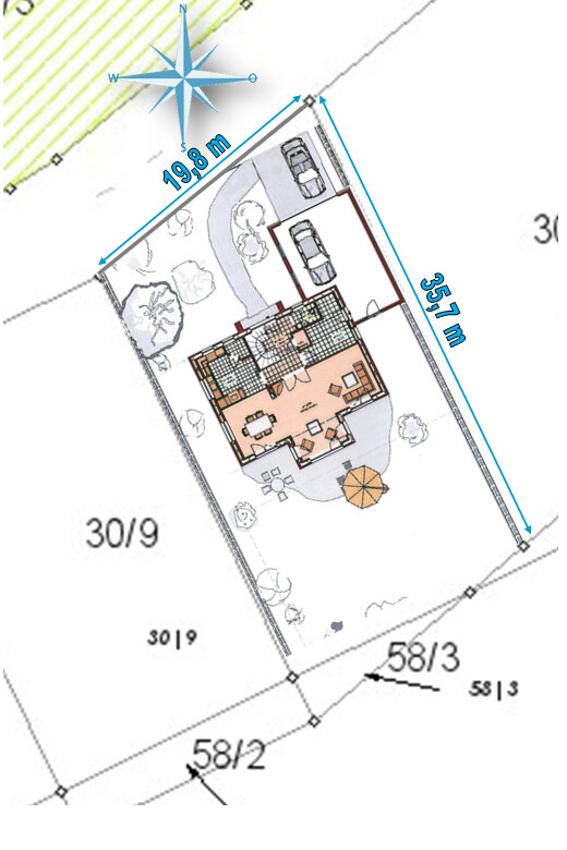

The Plot:
The current issue for us is the plot width of 19.8 m (65 feet). We know that there are certainly smaller/narrower plots, but we would like the roof side facing the street and to place the double carport beside the house. (Reason: A large front garden is not important to us, and with the north-facing orientation, it makes even less sense. You don’t gain anything from it—a smaller garden and higher maintenance effort.) Also, I personally don’t like it when the garage or double carport covers half of the house (a bit exaggerated, of course). In my opinion, this takes away from the charm of the house.
The House:
The problem that arises from this is that the house will inevitably have to be smaller (if the double carport is planned alongside it).
Originally, the following were important to us:
Ground Floor
- Gable with decorative bargeboards (front and back) // covered entrance area
- Bright and welcoming entrance hall with a view into the garden (looking straight through)
- Straight staircase to the upper floor; if curved, then only once (which would not be possible now)
- Small guest restroom
- Space for a "normal" guest coat/storage area
- Separate walk-in wardrobe room (not possible due to lack of space)
- Large utility/laundry room
- Access to the kitchen from the hallway (would no longer be possible)
- Large, open, bright, and light-filled living/dining/kitchen area with unobstructed access to the outside
Upper Floor
- Bright and friendly hallway, not too cramped
- Bedroom (only for one bed, due to severe dust mite allergy)
- Separate, spacious dressing room [I](only partially possible)
- Bathroom with walk-in shower, a long washbasin, freestanding bathtub, possibly a laundry chute, and potentially a sauna to be installed by ourselves > if there is space for a sauna, then a bathroom with balcony
- Two equally sized children’s rooms that are neither too small nor extremely large (not possible now or only partially)
- Option for an additional staircase to the attic or: space in the hallway for a small office corner

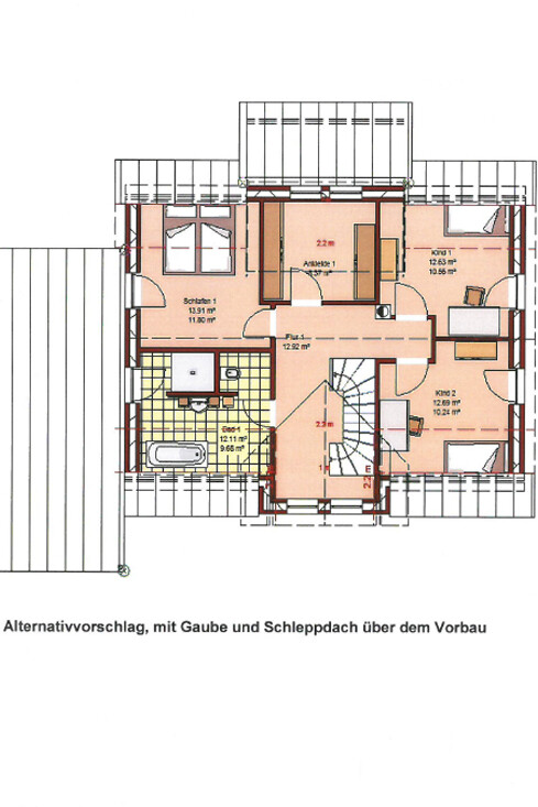

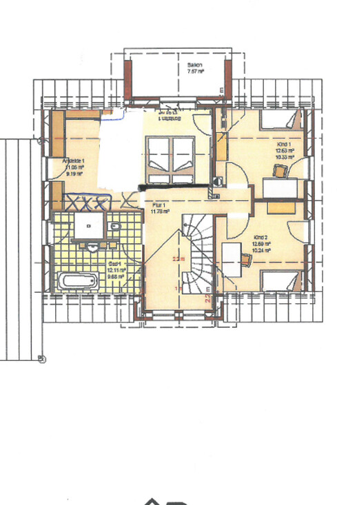

There would now be the option to place the double garage/double carport in front (Variant 1), giving the house about 150 sqm (1,615 sq ft) of living space, or beside it (Variant 2) with about 140 sqm (1,507 sq ft) of living space.
What do you think? Which option do you prefer?
How do you find the floor plan? Here is also the builder’s suggestion to remove the balcony and add a dormer instead. But I think the covered balcony is fantastic and very practical for drying laundry during the day, for sitting outside briefly in the evening, and for stepping outside in the morning while still in pajamas without going straight into the garden and being watched by neighbors. The view from the garden is great, and it’s a little luxury I really appreciate—you see... I’m in love!
Building a house is really difficult, and we are increasingly making compromises.
Initially, we wanted to build a house in a location where everything is nearby (kindergartens, shopping facilities, schools, doctors, etc.). However, building plots there cost almost twice as much as where we’re currently planning to build. This is a village only 2 km (1.2 miles) away from the other place, which does not really justify the much higher price there. The plot in the village with the great southwest orientation was unfortunately sold two days before we wanted to reserve it, so this plot remained. Now, the house may not fit on it as planned, and my partner is already leaning towards building a completely different house, without additional gables and with the regular gable side facing the street, meaning the roof would be oriented towards the neighboring properties. That way, the house could be larger again. However, I personally cannot get used to this idea at all, as I have always dreamed of such a house with Frisian or captain’s gables. This would be something completely different...
What do you think? Is it common to make such major compromises just to somehow fulfill the dream of owning a house and to fit it onto the plot?
By the way, gables are allowed there; we have already taken that into account in the planning.
Thank you in advance for your help!!

Bauexperte4 Aug 2015 12:04Hello Julia,
Maxime 700?
Of course, building a house always involves compromises; not every budget is large enough to implement all the "nice to have" features. Sometimes, the local building regulations (building permit / planning permission) simply prevent certain long-held wishes. It is equally wrong to approach the house-building process with a rigid, fixed idea. Because then the chance of finding the "right" plot becomes very slim!
I don’t see any mention of the possibility to add a garage or carport on both sides. In my opinion, this fits well with the look of a single-family house and limits your space planning much less.
Best regards, Bauexperte
Maxime 700?
Häuslebauer15 schrieb:It happens quite often... but: "somehow" is definitely the worst criterion for making a decision!
What do you think? Is it common to make such big compromises just to somehow fulfill the dream of building a house and to fit the house on the plot?

Häuslebauer154 Aug 2015 12:17Hello Building Expert,
You’re right. I always try to keep an open mind when reviewing ideas, additional zoning plans, etc. Often, this leads to completely new ideas or possibilities. However, there are a few things I would like to have fulfilled because I believe they simply make living in the house more comfortable. For example, a utility room accessible from the outside, a large utility room (since there is no basement), a walk-in closet (with a door to keep everything tidy – with children, there will eventually be a lot of stuff), and a kitchen accessible from the hallway so you don’t have to walk all the way around, etc.
We haven’t considered that possibility yet! Do you know if edge development would be allowed on both sides?
Thank you very much and best regards
Julia
Bauexperte schrieb:
I don’t see anything mentioned about the possibility of building a garage or carport on both sides. In my opinion, that fits well with the look of a single-family house and limits your space planning much less.
Julia
Bauexperte4 Aug 2015 12:43Hello Julia,
Häuslebauer15 schrieb:These are all quite normal wishes that can usually be incorporated into almost any design, as long as the plot allows a building envelope with a minimum width of 9.00 m (30 feet).
But there are just a few things I would like to have fulfilled ...
Häuslebauer15 schrieb:Of course – as long as the zoning plan does not explicitly prohibit it, which is rather rare, garages and carports may be built directly on the property boundary. In your case, it could look like this: Carport 3.00 m (10 feet) – single-family house 13.80 m (45 feet) – garage 3.00 m (10 feet).
We haven’t even thought about this option yet! Do you know if it would be possible to have a border construction on each side?
Häuslebauer154 Aug 2015 14:18Hello Building Expert,
That sounds really interesting! I’ll have to take a closer look at the development plan again this evening to see what exactly is specified about this.
Julia
Bauexperte schrieb:
Of course – as long as the development plan does not explicitly prohibit it, which is quite rare, garages or carports can be placed directly on the property boundary. In your case, it could look like this: Carport 3.00 m (10 feet) – Single-family house 13.80 m (45 feet) – Garage 3.00 m (10 feet)
Julia
