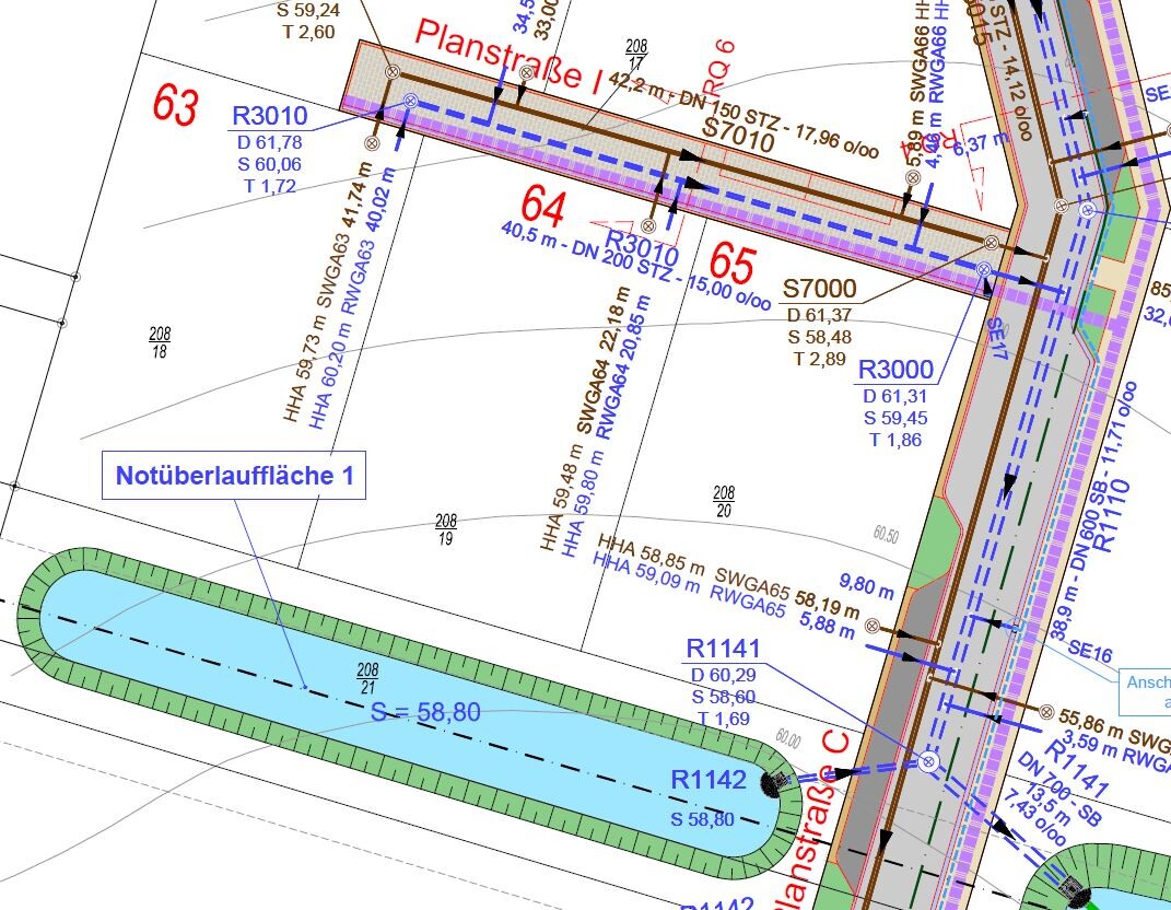

light-leicht14 Nov 2019 21:39Attached is an overview of the plot (No. 64). The plot is rectangular, measuring exactly 20m by 30.64m (65.6ft by 100.5ft).
The house is planned to be set back 6m (20ft) from the northern boundary, with the entire northern area designated as parking space.
The roof terrace should only extend up to 3m (10ft) from the neighboring boundary. That should be possible, right?
The floor plan has not yet been adjusted for furniture placement. This is just the room layout for now.
