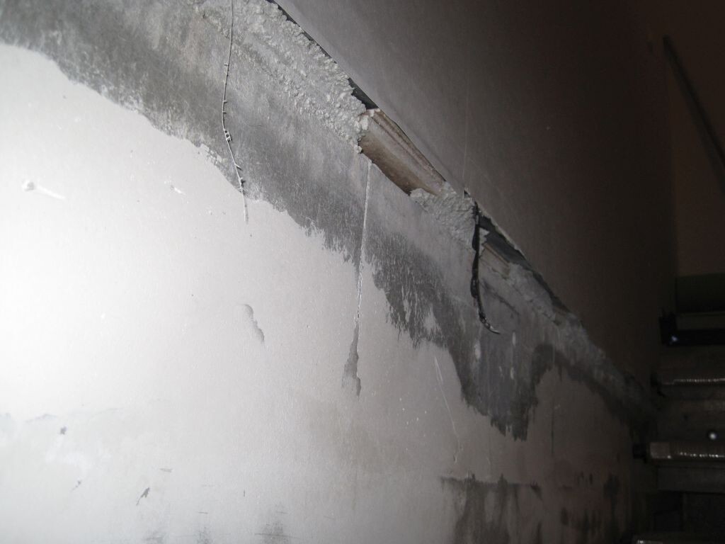

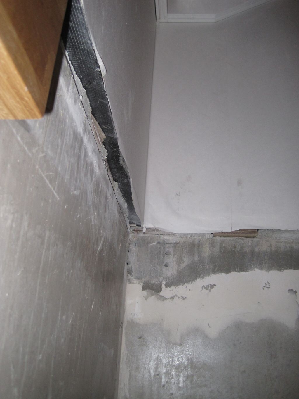

There is a step of about 2.5 to 3.5cm (1 to 1.4 inches) between the basement wall and the ground floor wall. The basement wall is recessed.
I would like to improve this area and would appreciate any suggestions.
I’m not sure if I can simply level it with filler because I’m concerned that the existing wood might swell. I also considered using some kind of trim (L-profile), but haven’t found a suitable option yet.
Maybe someone here has a brilliant idea?
Thanks in advance.
Jochen
Wall with moisture damage: peeling plaster, cracks, and dark spots.
Basement corner with damaged wall, flaking plaster and moisture on the concrete floor.
AOLNCM9 Jun 2017 12:14
It appears to be on the interior.
In the basement, attach impregnated drywall panels (green plasterboard) flush with the upper wall on both walls.
Don’t forget to apply mesh tape at the joints.

9 Jun 2017 13:22
We covered the transition with drywall (and commercial tape at the joints) and then applied continuous spray plaster. (Interior walls of the basement staircase).
It’s the opposite with the exterior wall; here, the basement wall is about 3 cm (1 inch) thicker and protrudes inward. We smoothed it evenly with filler and squared the edges at right angles. After applying the spray plaster, we simply attached a baseboard made from our flooring as a finishing edge.

Some builders here post pictures that give the impression they are afraid that anyone might recognize even the smallest detail beyond the damaged area of their house.
I admire anyone who can even remotely identify connections from such close-up shots like "Dalli Klick." It certainly doesn't make giving advice any easier.
Jochen2014 schrieb:
between the basement wall and the ground floor wall, there is a step of 2.5 to 3.5cm (1 to 1.4 inches).
Which walls are being referred to here exactly?
Jochen2014 schrieb:
because I fear that existing wood is swelling.
Which wood is being talked about?
The wooden corner piece in the picture could be a key box, or something completely different. As I said, close-up. I’m taking this seriously.
