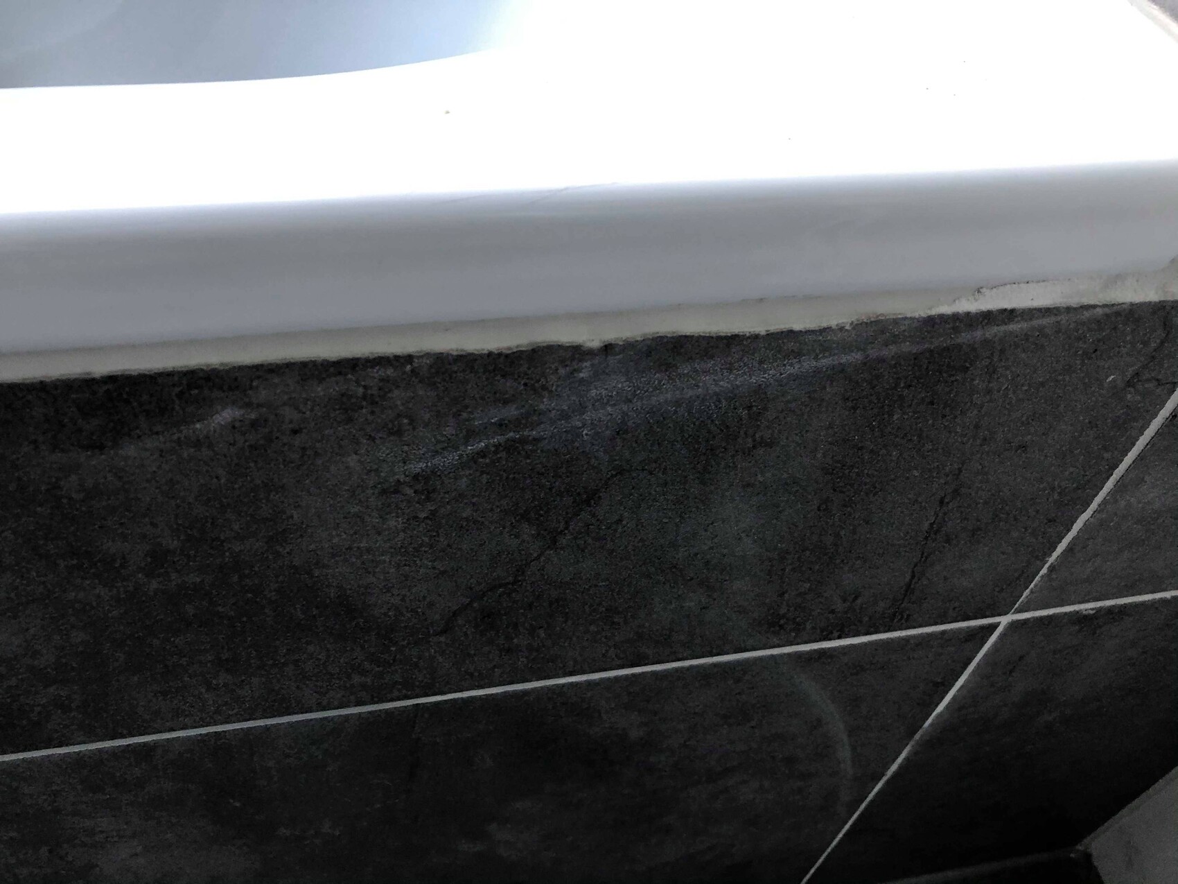

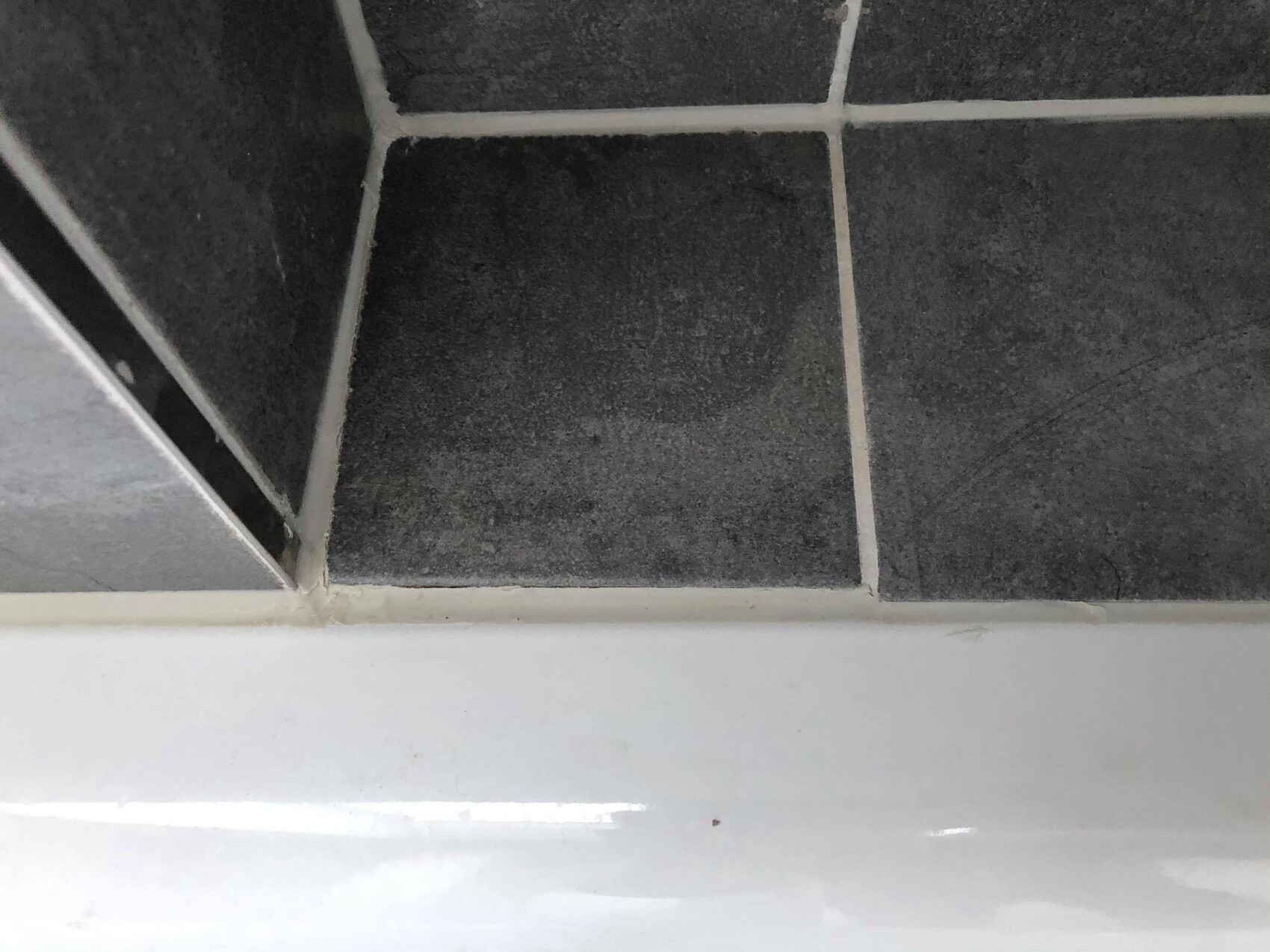

On the third attempt, everything was grouted, and the supervisor instructed the team that silicone should be applied between the tiles and the bathtub, for example. Instead of removing the tiles or taking other proper measures, they used a grinder. There are still residues from grouting visible in some places.

The grout lines look consistently disastrous.
Visible cut edges on more than 10 tiles.

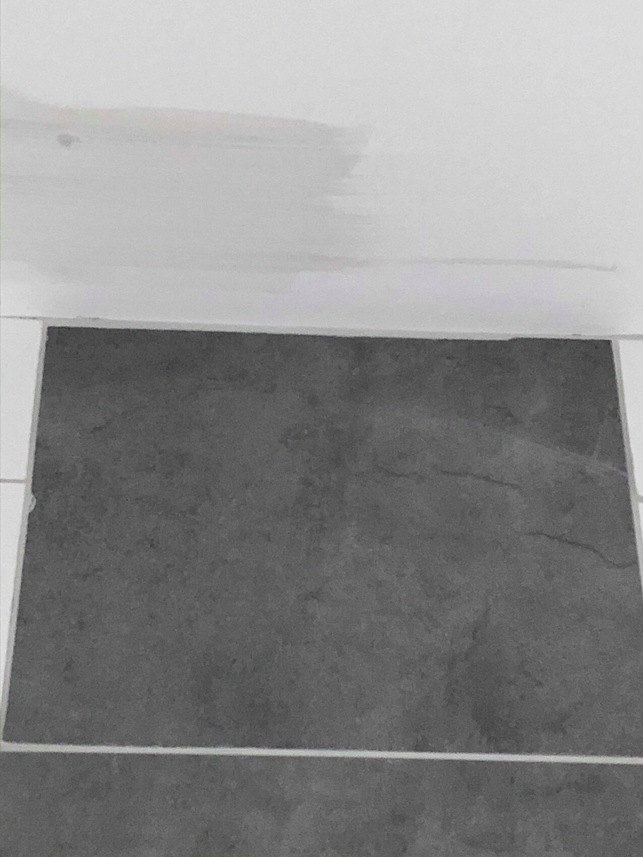

Some tiles are chipped, and the damage has been covered over with silicone.

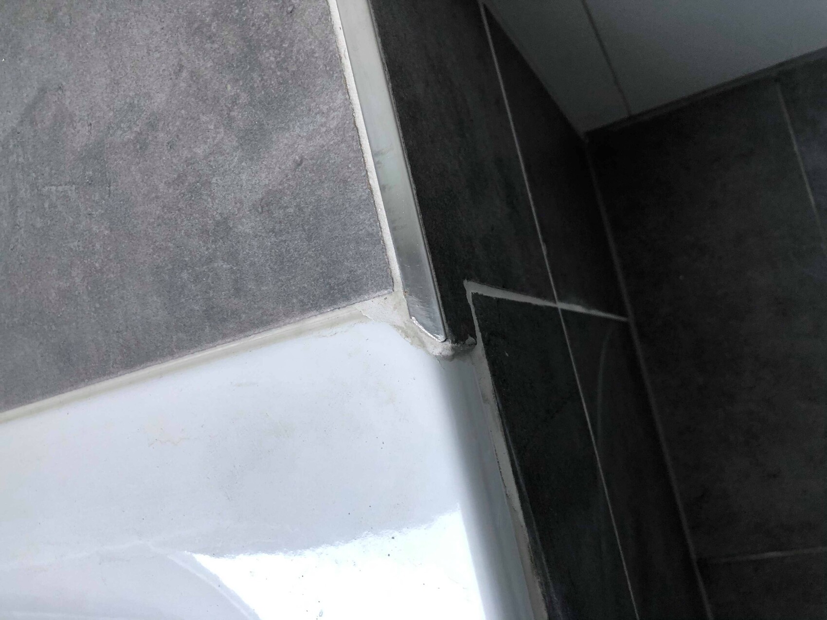

Corners of the rails were hammered at an angle.
