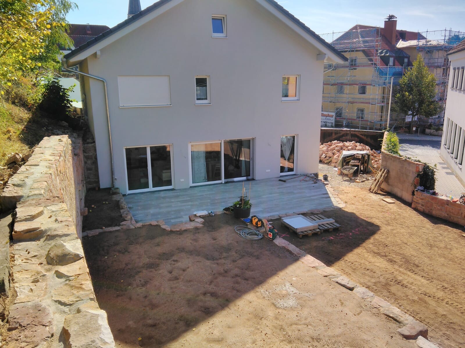

HilfeHilfe27 May 2020 08:04We built a retaining wall ourselves up to a maximum height of 2 meters (6.5 feet) and backfilled it.
Why? The foundation slab was already in place, BUT: we only have 480 square meters (5,167 square feet) of land anyway, and this way we were able to save/level about 35 square meters (377 square feet), making it usable.
So also consider whether the plot can be used at all without backfilling.
