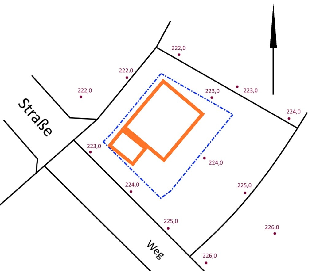

Here is our plan for the positioning of the garage and the house.
Also, here is an excerpt from our development plan. I had understood that terraces and garages do not necessarily have to be located within the building area. However, I am open to being corrected.
If we place the garage in front of the house, we face the problem that it blocks light to the basement. Therefore, we would prefer to position it on the side (see image) and move the main entrance to the other side, so that the terrace and similar areas are located in the southwest.

Thank you, that is helpful. So the garage should not be built on the property line, and everything is fine. However, the house you have drawn measures only 7.8m by 9m (26 ft by 30 ft), and the garage is only 3m by 4.5m (10 ft by 15 ft).

You are right. I did not draw the house and the garage in exact detail because we still don’t know the final size of the house.
However, I assume that the garage will no longer fit within the building area. But if I understood you correctly, that is not a problem as long as it is at least 2.5 meters (8 feet) away from the property boundary, right?
