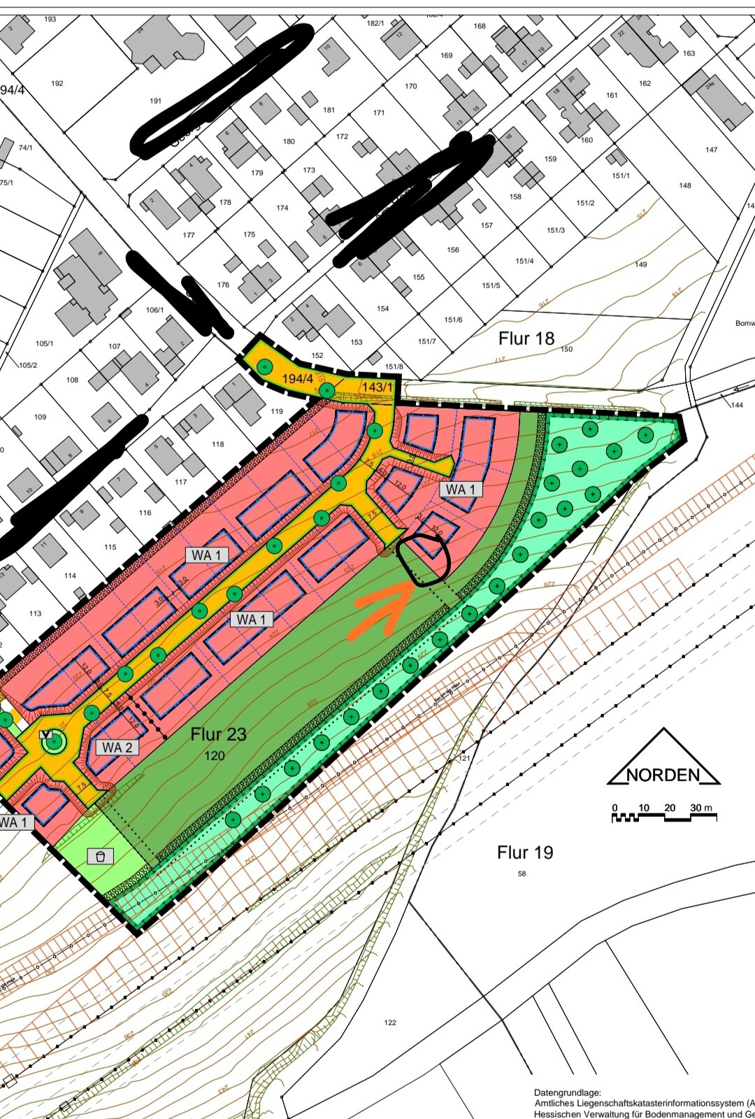

Our plot is located in a new development area, for which a soil report exists. This report does not indicate any special issues. We will obtain a soil report specific to our plot once we know exactly who we will build with.

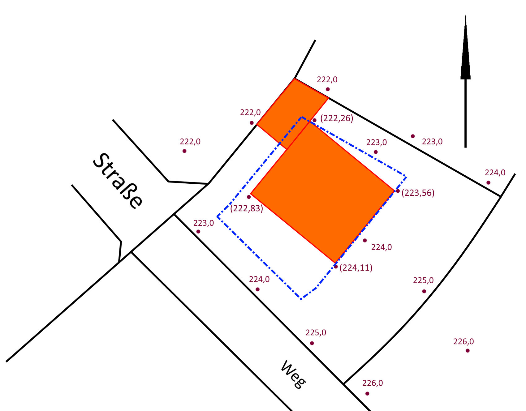

haydee schrieb:
Garage and building services, entrance, and 2 rooms in the basement The disadvantage here is that the lowest ground levels are located to the north. The garage or carport can only be placed where the ground is lowest. Here is the elevation situation using the example of a house measuring 9.50m (31 feet) by 11.00m (36 feet) and a garage measuring 6.00m (20 feet) by 4.00m (13 feet):

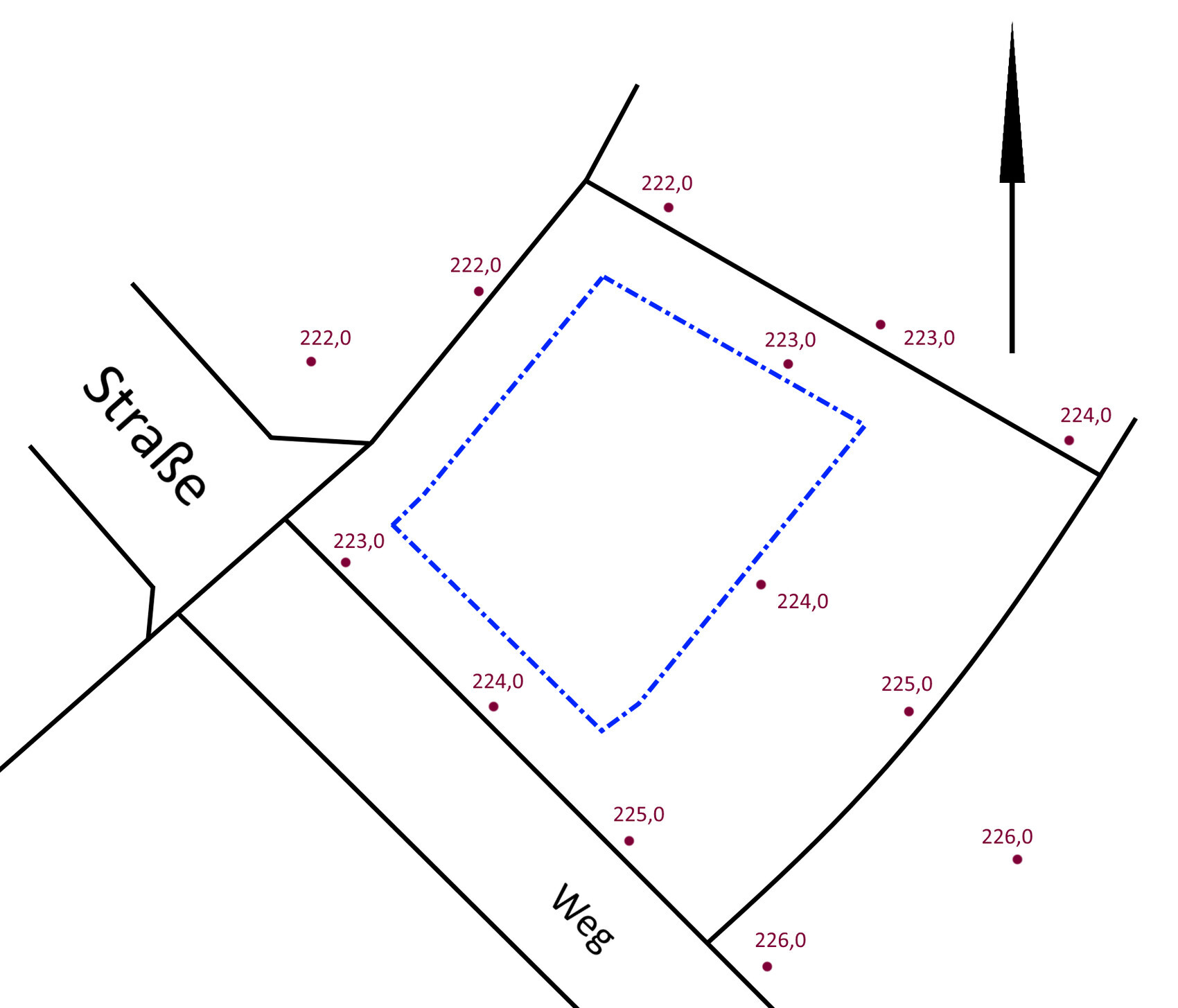

For other proposals, here is the site plan without any design (scale 1:100):
We had a very productive consultation yesterday. The plan includes a basement as the lower ground floor. The garage will be located on the west side of the house and will also serve as an additional terrace. At least, that is the plan. We will see what the final cost ends up being.
Thirteen schrieb:
The garage will be on the west side Since the plot is rotated almost 45° off north, you don’t really have a west side. Please show the site plan.
Thirteen schrieb:
will then serve as an additional terrace. In that case, it must comply with setback requirements. And where are the basement-level windows located then?
