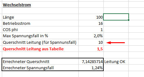

Thank you very much! This opens up completely new possibilities! Until now, I had always assumed just 1 constant power line and 1 switchable line.But be mindful of the total current if the blue wire is used solely as the neutral conductor, and avoid excessively long cable runs as mentioned above.Oops, okay.
Well, the 100 meters (330 feet) was a rough estimate.
But just the cable from the terrace to the device will probably reach 50 meters (165 feet).
If you also include the cable inside the house, the 100 meters (330 feet) doesn’t seem that exaggerated.
I think in the end, one loop will be about 10 meters (33 feet) and the other about 50 meters (165 feet) measured from the terrace.
But the underground cable currently in place is only 2.5 mm² (about 3 AWG) if I remember correctly.
So, using a thicker cable for the rest of the garden wouldn’t really make a difference, right?

No, that doesn’t really help, because the bottleneck would be the connection to the cable with 2.5mm² (2.75 sq. ft). As someone already mentioned here, a junction box or panel distributor would be a good solution. You would install a 6A fuse for the 50m (165 ft) cable and a 16A fuse for the 10m (33 ft) cable. But only if you use 2 neutral conductors.
