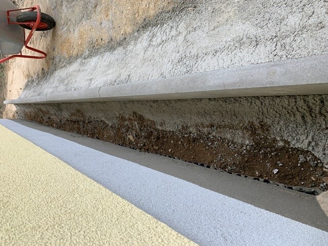

Andre77
28 Oct 2020 13:10
After the concrete cleanup, it looks like this ...
Construction scene: concrete beam over soil with gravel, smooth concrete slab underneath.
Construction site: long gray beam lies in an excavation next to a wall; red cart at the edge.
seat8828 Oct 2020 13:29
A thousand times better
borderpuschl
28 Oct 2020 13:48
It was worth it after all. In my opinion, this is sufficient.

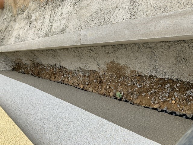

Andre77
28 Oct 2020 14:17
That would have been my question...
So, can I start filling in the gravel now?
By the way, how should I handle this? Does the gravel need to be of a certain size to prevent anything from falling through? Because this will be covered up...
Orange plastic pipe next to a gray pipeline in an excavation beside a concrete wall.
tomtom7928 Oct 2020 14:24
Don’t forget to lay a membrane to protect the wall.
