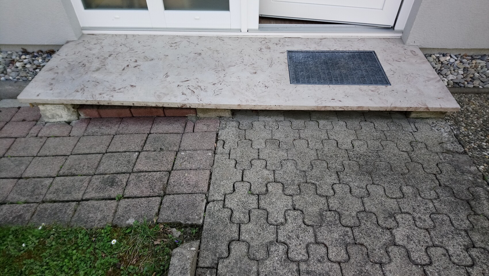

Light stone porch as a step in front of the front door with metal mesh; paved path in front.

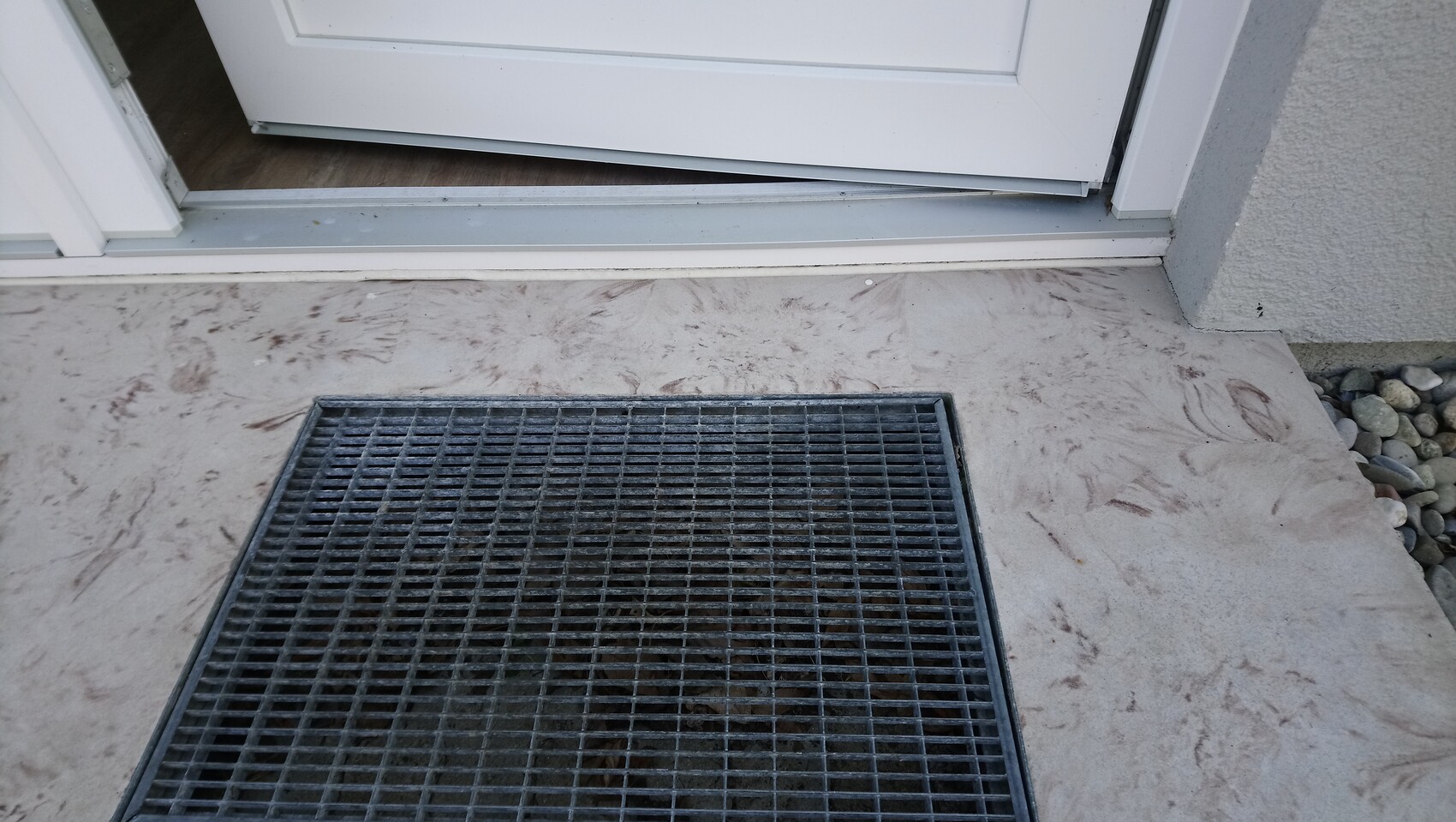

White front door slightly open; in front a metal mesh cover in light concrete, gravel on the right.

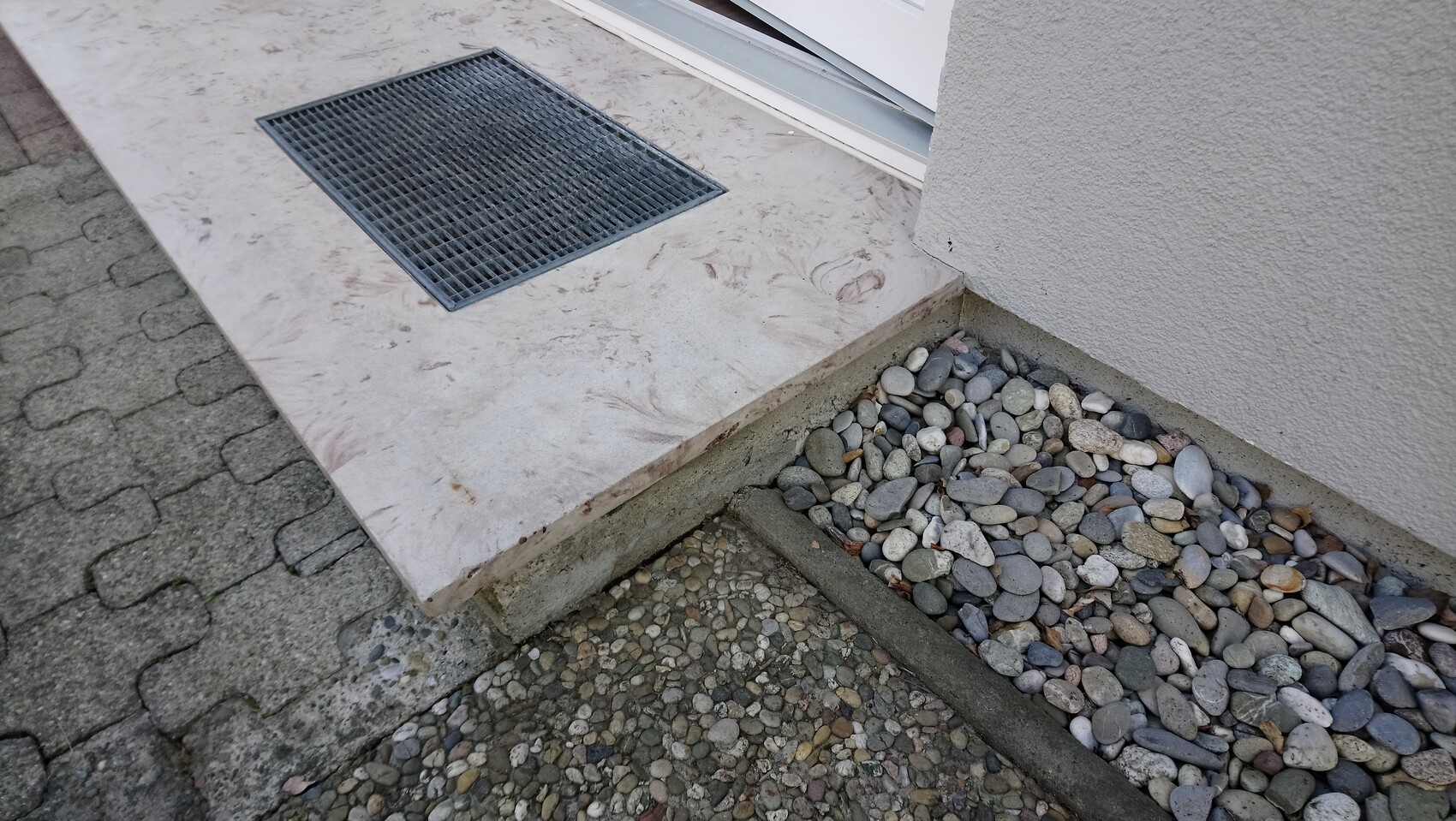

Entrance with beige marble floor tile, metal grate and gravel stone floor beside it.

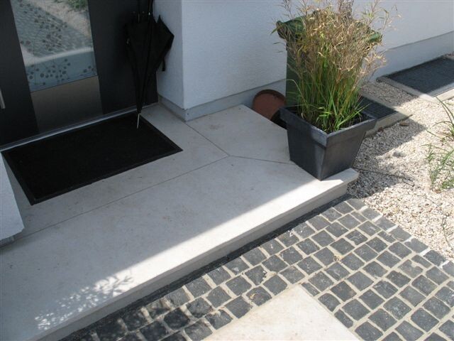

Entrance area with light steps, umbrella, planter with grass in front of the door.

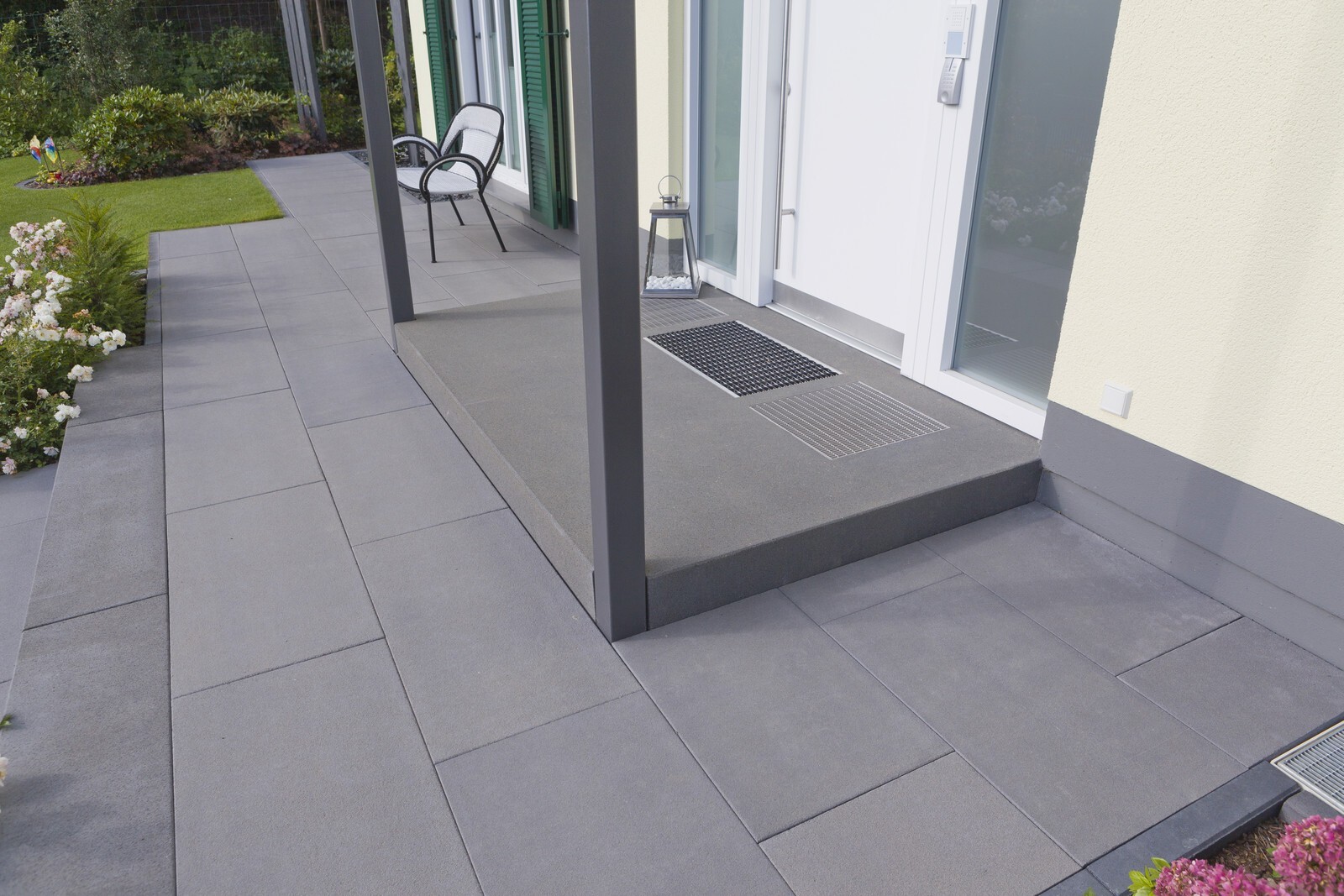

Modern terrace in front of a house: gray large-format paving slabs, chair, lantern, and glass door.

The last three pictures are sample suggestions of how it could approximately look.
