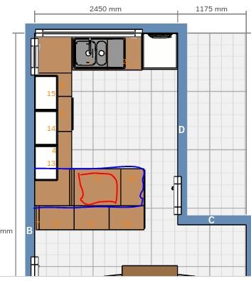

As a beginner, I now have to bring up an issue that’s been troubling me.
We want to integrate the cooktop into a kind of kitchen island (marked in red in the picture). So far, I have planned to use a Bora (or similar) system with recirculation mode. Now I’m reconsidering this (partly because it seems Bora systems should only be installed by professionals, etc.). How can I find topics and posts about extraction hoods, for example from Bora or similar brands?
Alternatively, I’m now thinking about a ceiling extractor. An exhaust version would probably be better here. That’s certainly more comfortable. On the other hand, it pains me to cut a hole in the wall of the new house right away. Energetically, it’s not optimal, but this way you save yourself from having to change filters and remove humidity from the room.
I don’t like hanging recirculation solutions. Nor the ones that are built in a more classic way and connected to the ceiling by a “tower.” So I quickly ended up with a fully integrated ceiling extractor. For this, you would need to build some kind of box. It could extend from the wall to the end of the cooktop and also include lighting.

PS: Since the worktop is about 83cm (33 inches) high, and the ceiling is 2.46m (8 ft 1 in) high, the extractor would be at about 2.10m (6 ft 11 in) — so roughly 127cm (50 inches) above the stove. Does that work well? Since the expensive Bora is off the table, I would be willing to buy a good and expensive hood (any recommended manufacturers? Miele costs around $1800, for example – a good 80cm (32 inches) stove costs about $1500, so the price is similar).

The advantages of having the cooktop against the wall include the absence of cross drafts, which you experience with an island and which negatively affect the performance of the range hood.
However, according to your drawing, you have just under 50cm (20 inches) of clearance between the wall and the cabinet where you plan the island. How do you envision that working? Even if the door opens outward, that is extremely tight, allowing only very slim people to fit into the kitchen. If those are the room dimensions, I would strongly recommend planning either an L-shaped layout or a double-run kitchen there.
By the way, the working height is 93cm (37 inches), not 83cm (33 inches).

The passage is currently 58.5cm (23 inches) wide. Of course, it’s not a barn door, but I don’t know anyone who would have trouble getting through.
Two rows won’t work because that would leave only 1.10m (43 inches) in the middle, which is really tight. I’d rather have just one short narrow spot. With an L-shaped layout, there’s very little space, and I also don’t find it aesthetically pleasing.
The issue with the refrigerator is true, but unfortunately can’t be changed. From the wall to the window, there are only 60cm (24 inches). That’s why we want to use handleless fronts here, to avoid anything hitting the wall.
