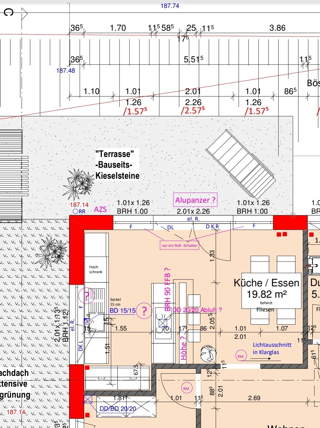

Anolca* schrieb:
The stairwell is freezing cold at the moment. Creepy.That doesn’t happen in new builds, or only if you don’t heat at all.I actually see the child’s bedroom in an unfortunate location. There might be noise from the utility room and the housekeeping room. Depending on how sensitive your child is to noise, make sure to position the equipment in both rooms well, so not directly on the shared wall. Would it be an option to swap the bathroom and the child’s bedroom?
I’m also curious about the dining room furniture. You mention a bench next to the French door. Where would the table be then? Wouldn’t it be in the way if you want to go into the kitchen?
kaho674 schrieb:
Hey there:
By "cold area," I guess you mean a hallway. By the way: You might want to reconsider the idea of not heating certain rooms in a new house built according to the energy saving regulations (and presumably with underfloor heating) to save energy.
If your daughter is afraid of dark rooms, wouldn’t it be quite problematic for her on the way to her bedroom downstairs? That’s not an issue? I guess, "there is no way around it there".
There’s also a cat flap in the guest bathroom door? Awesome. Not only can you hear every little noise in the living room, now the cat can come in uninvited during my throne time and sneak past me. Cool.
Anyway, there’s no point in challenging the fundamentals here. It’s too late for that. It’s not a disaster either. As long as you’re happy, so are we. There is a big difference between our daughter being able to move around freely and without fear during the day and being taken to bed with company, and her being very stressed every time she goes to the bathroom during the day or constantly needing someone with her.
We are building our house for ourselves, not for visitors. Anyone who wants to peacefully enjoy their throne time can do so one floor down.
Ibdk14 schrieb:
I actually see the child’s bedroom as being in an unfortunate location. Possibly noise from the utility room and the laundry room. Depending on how sensitive your child is to noise, make sure the appliances in both rooms are well placed, ideally not on the shared wall. Would swapping the bathroom and the child’s bedroom be an option?
I’m also curious about the dining room furniture. You mentioned a bench next to the French door. Where will the table be then? Won’t it be in the way if you want to go into the kitchen? She finds noises she’s used to rather comforting.
I honestly don’t think the table in the kitchen will be in the way. A corner bench will go in the corner, and the table will be placed lengthwise next to it.
The right door panel will be the first to open, not like in the picture.
