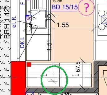

@Anolca* ... hmm .. hm ...
If I were to design the kitchen layout, I wouldn’t place a half-height cabinet next to the freestanding refrigerator.
Instead, I would make the recess at the bottom of the plan
about 190 cm (75 inches) wide and fit tall cabinets and a blind corner there. That would also include the dishwasher. Next to the refrigerator, I would just have a base cabinet. For this, you might need to move the wall to the children’s room about 10 to 15 cm (4 to 6 inches) further to the right or shift the door to the children’s room further down on the plan.
Then I noticed the sill height… how is it specified? Is it from the top of the raw floor or the finished floor? If I consider the large window area, I assume it’s from the top of the raw floor, but that means the window on the left will have a sill height below 100 cm (39 inches) in the finished state, which wouldn’t match the kitchen plan.
Regarding the kitchen island, if it is only supposed to be 200 cm (79 inches) wide, I would build the base cabinets from the bottom of the plan as 40 cm (16 inches) – 80 cm (31 inches) – 80 cm (31 inches). This way, one side would have more workspace, and ideally, you could create a breakfast bar or seating area at countertop height. That way, the peninsula can also be better used as a buffet or serving area. I would also opt for deep base cabinets since you don’t have that much storage space.
Positioning the sink and cooktop directly opposite each other is not a good choice. It’s better to arrange them offset. I would eliminate the corner next to the kids’ room and opt for two straight runs. Corners in kitchens tend to cause congestion.
As Kerstin mentioned, there are only short countertop sections everywhere.
Also, the dimension of 151cm (60 inches) to the sanitary area is not correctly shown. The measurement doesn’t end at the bottom wall but somewhere in the middle. How is it supposed to be?
The plinth height of 15cm (6 inches) is quite high. Which manufacturer are you planning to use, or who is the main supplier for the kitchen?
The windowsill height could have been matched to the countertop height. If the windowsill height is supposed to be 90cm (35 inches, question mark), then you only have a 72cm (28 inches) cabinet body. This can be improved.
