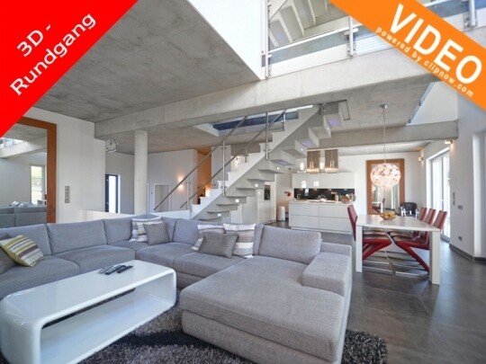

The staircase is great and absolutely our choice. Attached are some pictures showing how it will look similarly.
