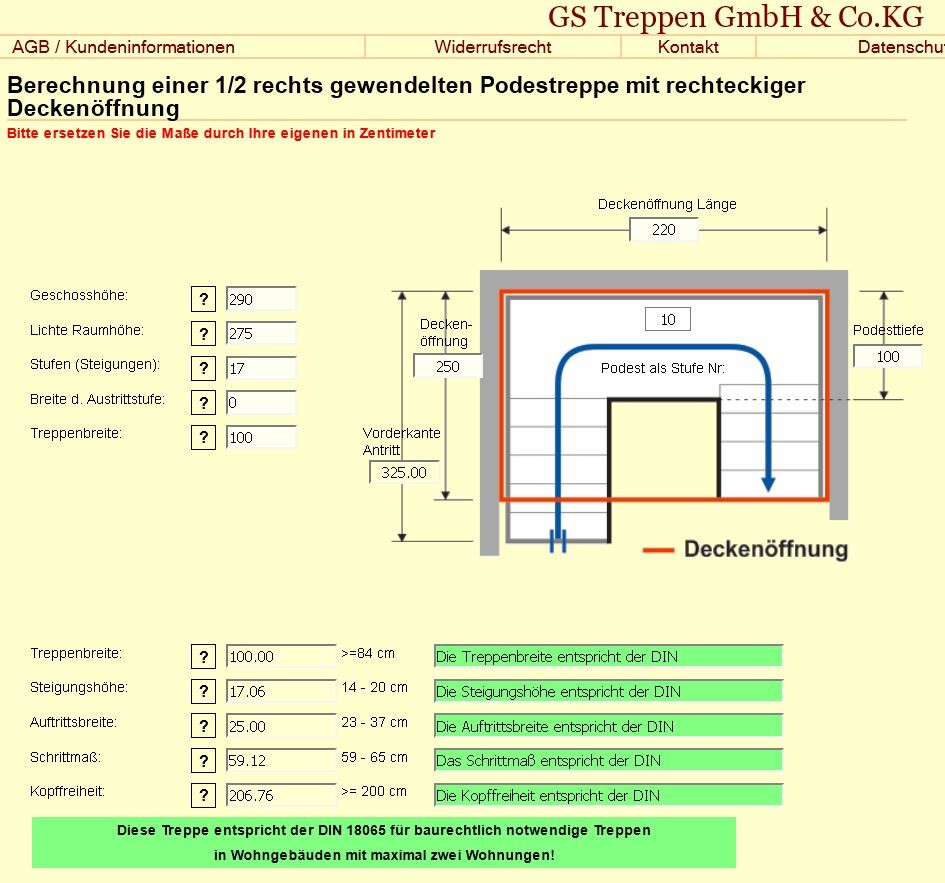

derpikniker4 Nov 2018 18:12kbt09 schrieb:
Yes, the staircase to the attic works with a 50 cm (20 inch) knee wall if you measure from the centerline of the stairs. That’s why I always referred to a 0 cm (0 inch) knee wall. This discussion would have been over long ago if that information had been shared. After all, I also created the example stair layouts.Take a look here: In post #41 I was wondering why you insisted so strongly on the 0 cm (0 inch) measurement. kaho674 schrieb:

By the way, I printed out your ground floor plan and compared it with mine. The differences aren’t significant and mainly concern the rear kitchen area, aside from the offset staircase. I see that as a positive for my living and dining area plans, which I have revised again and coordinated with my wife. It should now be set. We owe that to you.
