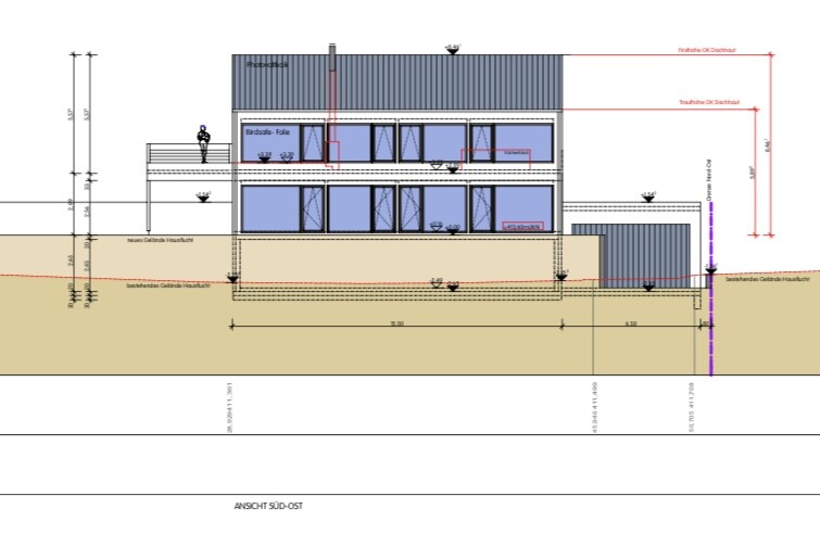

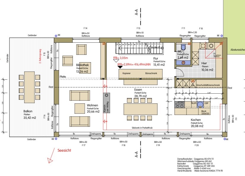

Floor plan of a house with garage, terrace, and multiple rooms.
Floor plan of a house with hallway, master bedroom, children's room, guest room, and terrace.
Floor plan of a residential house with balcony, living room, library, dining area, kitchen, and hallway.
Cross-section through a multi-story house with attic, ground floor, basement, stairs, and windows.
Modern two-story house drawing with terrace, large windows, dimension lines, and terrain profile.
Yes, the hallway on the ground floor and basement is dark. That was a compromise we had to accept building on a slope. It was more important to us that the living spaces receive enough natural light. In the stairwell, we installed LED strips that stay on throughout the day.
