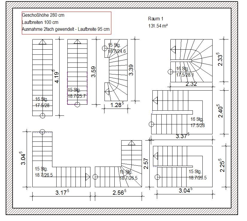

Thanks for the feedback.
The design feels like the hundredth iteration by now. We actually thought it was almost final and only needed minor adjustments (exact staircase length, kitchen, etc.).
I’ve already tried the paper and pencil approach as well.
The problem lies with the following constraints:
- Plot width 20m (65.6 feet)
- Double garage on the north side and directly attached to the house → lots of wall without windows → max house width 9.5m (31.2 feet)
- Living/dining area should face the garden
- Bedrooms also facing the garden
- Kitchen with pantry

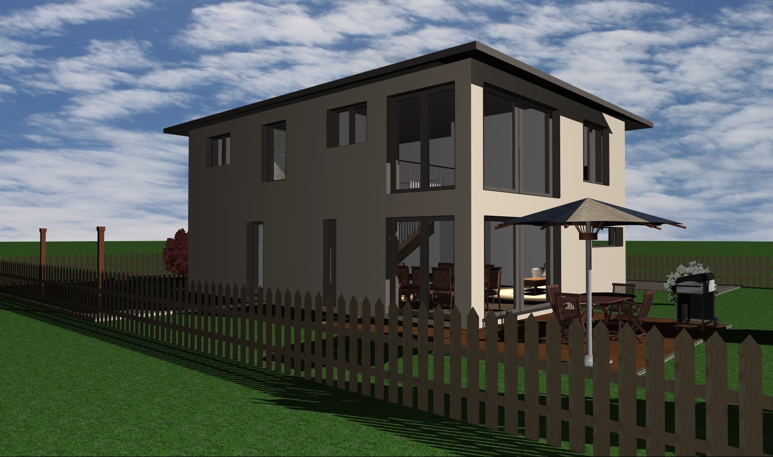

We really like the open space concept; we’ve already seen it in a Weberhaus show home. What appeals to us most is the glazing across two floors, which creates a nice openness on both levels and brings the garden into the house (see attachment).
If practicality were the only concern, a Town & Country Raumwunder 100 model would be sufficient.
I also find it extremely hard to come up with something new; somehow I always end up with a similar result.
And going to the architect without any draft at all probably isn’t very productive either. It’s not rocket science, and the architect isn’t a magician. I believe you should be able to manage this yourself as well.
How would you recommend starting a new design? With the staircase? Almost every change affects both floors, and as mentioned, you also have to consider things like waste pipes, ceiling lining, etc.
